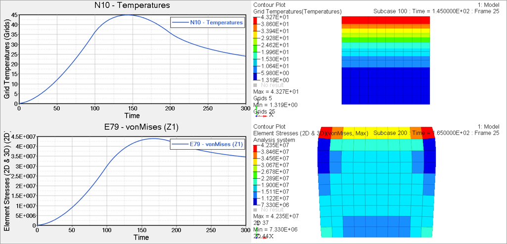

Linear and nonlinear OSTTS runs provide displacement and stress history for the duration of transient heat transfer. To capture the stress history accurately, you do not need as many time steps as Transient Heat Transfer Analysis. It is recommended to keep the number of output time steps (internal subcases) less than 50. When MUMPS solver is used, the upper limit for the number of boundary conditions is 200.

Figure 1. Temperature History and Peak Stress of One Step Transient Thermal Stress Analysis
