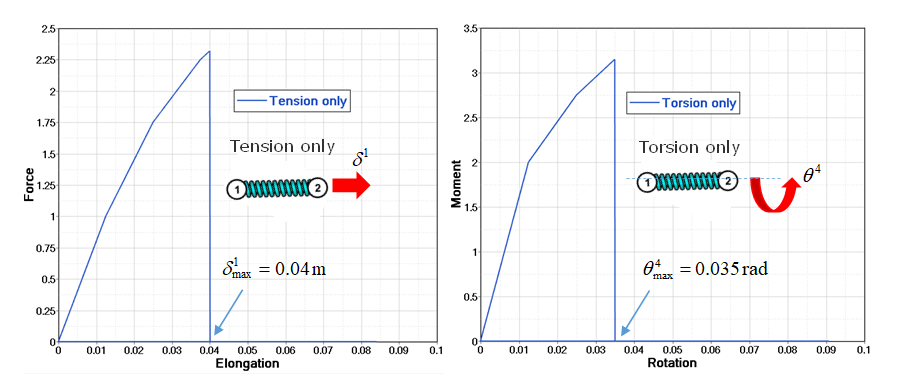

    Examples of failure behaviors of uni-directional failure are:
    If δ max 1 = 0.04 m MathType@MTEF@5@5@+= feaagKart1ev2aqatCvAUfeBSjuyZL2yd9gzLbvyNv2CaerbuLwBLn hiov2DGi1BTfMBaeXatLxBI9gBaerbd9wDYLwzYbItLDharqqtubsr 4rNCHbGeaGqiVu0Je9sqqrpepC0xbbL8F4rqGqFfpeea0xe9vq=Jb9 vqpeea0xd9q8qiYRWxGi6xij=hbba9q8aq0=yq=He9q8qiLsFr0=vr 0=vr0db8meaabaqaciGacaGaaeqabaWaaeaaeaaakeaacqaH0oazda qhaaWcbaGaciyBaiaacggacaGG4baabaGaaGymaaaakiabg2da9iaa icdacaGGUaGaaGimaiaaisdaciGGTbaaaa@41B0@ in a tension only test, then there is spring failure, and the force goes to zero once the elongation reaches 0.04m.
    The same is true for rotation, if θ max 4 = 0.035 rad MathType@MTEF@5@5@+= feaagKart1ev2aqatCvAUfeBSjuyZL2yd9gzLbvyNv2CaerbuLwBLn hiov2DGi1BTfMBaeXatLxBI9gBaerbd9wDYLwzYbItLDharqqtubsr 4rNCHbGeaGqiVu0Je9sqqrpepC0xbbL8F4rqGqFfpeea0xe9vq=Jb9 vqpeea0xd9q8qiYRWxGi6xij=hbba9q8aq0=yq=He9q8qiLsFr0=vr 0=vr0db8meaabaqaciGacaGaaeqabaWaaeaaeaaakeaacqaH4oqCda qhaaWcbaGaciyBaiaacggacaGG4baabaGaaGinaaaakiabg2da9iaa icdacaGGUaGaaGimaiaaiodacaaI1aGaciOCaiaacggacaGGKbaaaa@4454@ , the spring fails and has zero force at 0.035rad.

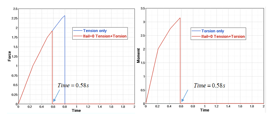

    If a spring is subject to two load cases, for example, tension and torsion and Ifail = 0 (uni-directional failure) is in use, then spring failure occurs if either one of the failure criteria is reached.
    Here the rotation criteria is reached first (at Time=0.58s), then the force and moment fall to zero at the same time.
    Figure 3.

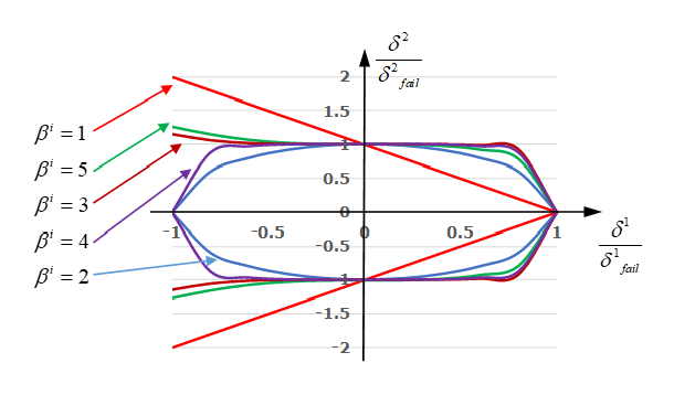

  • Muli-directional (Ifail = 1)
    If the criteria is multi-directional, all degrees of freedom are coupled and failure occurs when:(1)
    ∑ i = 1 , 2 , 3 α i ( δ i δ i f a i l ) β i + ∑ i = 4 , 5 , 6 α i ( θ i θ i f a i l ) β i ≥ 1 MathType@MTEF@5@5@+= feaagKart1ev2aaatCvAUfeBSjuyZL2yd9gzLbvyNv2CaerbuLwBLn hiov2DGi1BTfMBaeXatLxBI9gBaerbd9wDYLwzYbItLDharqqtubsr 4rNCHbGeaGqiVu0Je9sqqrpepC0xbbL8F4rqqrFfpeea0xe9Lq=Jc9 vqaqpepm0xbbG8FasPYRqj0=yi0dXdbba9pGe9xq=JbbG8A8frFve9 Fve9Ff0dmeaabaqaciGacaGaaeqabaWaaeaaeaaakeaadaaeqbqaai abeg7aHnaaCaaaleqabaGaamyAaaaakmaabmaabaWaaSaaaeaacqaH 0oazdaahaaWcbeqaaiaadMgaaaaakeaacqaH0oazdaahaaWcbeqaai aadMgaaaGcdaWgaaWcbaGaamOzaiaadggacaWGPbGaamiBaaqabaaa aaGccaGLOaGaayzkaaaaleaacaWGPbGaeyypa0JaaGymaiaacYcaca aIYaGaaiilaiaaiodaaeqaniabggHiLdGcdaahaaWcbeqaaiabek7a InaaCaaameqabaGaamyAaaaaaaGccqGHRaWkdaaeqbqaaiabeg7aHn aaCaaaleqabaGaamyAaaaakmaabmaabaWaaSaaaeaacqaH4oqCdaah aaWcbeqaaiaadMgaaaaakeaacqaH4oqCdaahaaWcbeqaaiaadMgaaa GcdaWgaaWcbaGaamOzaiaadggacaWGPbGaamiBaaqabaaaaaGccaGL OaGaayzkaaaaleaacaWGPbGaeyypa0JaaGinaiaacYcacaaI1aGaai ilaiaaiAdaaeqaniabggHiLdGcdaahaaWcbeqaaiabek7aInaaCaaa meqabaGaamyAaaaaaaGccqGHLjYScaaIXaaaaa@6AEC@
    Where, δ i f a i l MathType@MTEF@5@5@+= feaagKart1ev2aaatCvAUfeBSjuyZL2yd9gzLbvyNv2CaerbuLwBLn hiov2DGi1BTfMBaeXatLxBI9gBaerbd9wDYLwzYbItLDharqqtubsr 4rNCHbGeaGqiVu0Je9sqqrpepC0xbbL8F4rqqrFfpeea0xe9Lq=Jc9 vqaqpepm0xbbG8FasPYRqj0=yi0dXdbba9pGe9xq=JbbG8A8frFve9 Fve9Ff0dmeaabaqaciGacaGaaeqabaWaaeaaeaaakeaacqaH0oazda ahaaWcbeqaaiaadMgaaaGcdaWgaaWcbaGaamOzaiaadggacaWGPbGa amiBaaqabaaaaa@3D04@ and θ i f a i l MathType@MTEF@5@5@+= feaagKart1ev2aaatCvAUfeBSjuyZL2yd9gzLbvyNv2CaerbuLwBLn hiov2DGi1BTfMBaeXatLxBI9gBaerbd9wDYLwzYbItLDharqqtubsr 4rNCHbGeaGqiVu0Je9sqqrpepC0xbbL8F4rqqrFfpeea0xe9Lq=Jc9 vqaqpepm0xbbG8FasPYRqj0=yi0dXdbba9pGe9xq=JbbG8A8frFve9 Fve9Ff0dmeaabaqaciGacaGaaeqabaWaaeaaeaaakeaacqaH4oqCda ahaaWcbeqaaiaadMgaaaGcdaWgaaWcbaGaamOzaiaadggacaWGPbGa amiBaaqabaaaaa@3D15@ are failure criteria. Refer to Failure Criteria for more details.
    For property TYPE8, α i = 1 MathType@MTEF@5@5@+= feaagKart1ev2aaatCvAUfeBSjuyZL2yd9gzLbvyNv2CaerbuLwBLn hiov2DGi1BTfMBaeXatLxBI9gBaerbd9wDYLwzYbItLDharqqtubsr 4rNCHbGeaGqiVu0Je9sqqrpepC0xbbL8F4rqqrFfpeea0xe9Lq=Jc9 vqaqpepm0xbbG8FasPYRqj0=yi0dXdbba9pGe9xq=JbbG8A8frFve9 Fve9Ff0dmeaabaqaciGacaGaaeqabaWaaeaaeaaakeaacqaHXoqyda ahaaWcbeqaaiaadMgaaaGccqGH9aqpcaaIXaaaaa@3AE3@ and β i = 2 MathType@MTEF@5@5@+= feaagKart1ev2aaatCvAUfeBSjuyZL2yd9gzLbvyNv2CaerbuLwBLn hiov2DGi1BTfMBaeXatLxBI9gBaerbd9wDYLwzYbItLDharqqtubsr 4rNCHbGeaGqiVu0Je9sqqrpepC0xbbL8F4rqqrFfpeea0xe9Lq=Jc9 vqaqpepm0xbbG8FasPYRqj0=yi0dXdbba9pGe9xq=JbbG8A8frFve9 Fve9Ff0dmeaabaqaciGacaGaaeqabaWaaeaaeaaakeaacqaHYoGyda ahaaWcbeqaaiaadMgaaaGccqGH9aqpcaaIYaaaaa@3AE6@ (failure criteria shown as blue curve in Figure 4).
    For properties TYPE13 and TYPE25, arbitrary α i , β i MathType@MTEF@5@5@+= feaagKart1ev2aaatCvAUfeBSjuyZL2yd9gzLbvyNv2CaerbuLwBLn hiov2DGi1BTfMBaeXatLxBI9gBaerbd9wDYLwzYbItLDharqqtubsr 4rNCHbGeaGqiVu0Je9sqqrpepC0xbbL8F4rqqrFfpeea0xe9Lq=Jc9 vqaqpepm0xbbG8FasPYRqj0=yi0dXdbba9pGe9xq=JbbG8A8frFve9 Fve9Ff0dmeaabaqaciGacaGaaeqabaWaaeaaeaaakeaacqaHXoqyda ahaaWcbeqaaiaadMgaaaGccaGGSaGaeqOSdi2aaWbaaSqabeaacaWG Pbaaaaaa@3C8E@ may be input with α i > 0 MathType@MTEF@5@5@+= feaagKart1ev2aaatCvAUfeBSjuyZL2yd9gzLbvyNv2CaerbuLwBLn hiov2DGi1BTfMBaeXatLxBI9gBaerbd9wDYLwzYbItLDharqqtubsr 4rNCHbGeaGqiVu0Je9sqqrpepC0xbbL8F4rqqrFfpeea0xe9Lq=Jc9 vqaqpepm0xbbG8FasPYRqj0=yi0dXdbba9pGe9xq=JbbG8A8frFve9 Fve9Ff0dmeaabaqaciGacaGaaeqabaWaaeaaeaaakeaacqaHXoqyda ahaaWcbeqaaiaadMgaaaGccqGH+aGpcaaIWaaaaa@3AE4@ (default is α i = 1 MathType@MTEF@5@5@+= feaagKart1ev2aaatCvAUfeBSjuyZL2yd9gzLbvyNv2CaerbuLwBLn hiov2DGi1BTfMBaeXatLxBI9gBaerbd9wDYLwzYbItLDharqqtubsr 4rNCHbGeaGqiVu0Je9sqqrpepC0xbbL8F4rqqrFfpeea0xe9Lq=Jc9 vqaqpepm0xbbG8FasPYRqj0=yi0dXdbba9pGe9xq=JbbG8A8frFve9 Fve9Ff0dmeaabaqaciGacaGaaeqabaWaaeaaeaaakeaacqaHXoqyda ahaaWcbeqaaiaadMgaaaGccqGH9aqpcaaIXaaaaa@3AE3@ ). Figure 4 shows failure criteria with different β i MathType@MTEF@5@5@+= feaagKart1ev2aaatCvAUfeBSjuyZL2yd9gzLbvyNv2CaerbuLwBLn hiov2DGi1BTfMBaeXatLxBI9gBaerbd9wDYLwzYbItLDharqqtubsr 4rNCHbGeaGqiVu0Je9sqqrpepC0xbbL8F4rqqrFfpeea0xe9Lq=Jc9 vqaqpepm0xbbG8FasPYRqj0=yi0dXdbba9pGe9xq=JbbG8A8frFve9 Fve9Ff0dmeaabaqaciGacaGaaeqabaWaaeaaeaaakeaacqaHYoGyda ahaaWcbeqaaiaadMgaaaaaaa@391A@ .
    Figure 4.

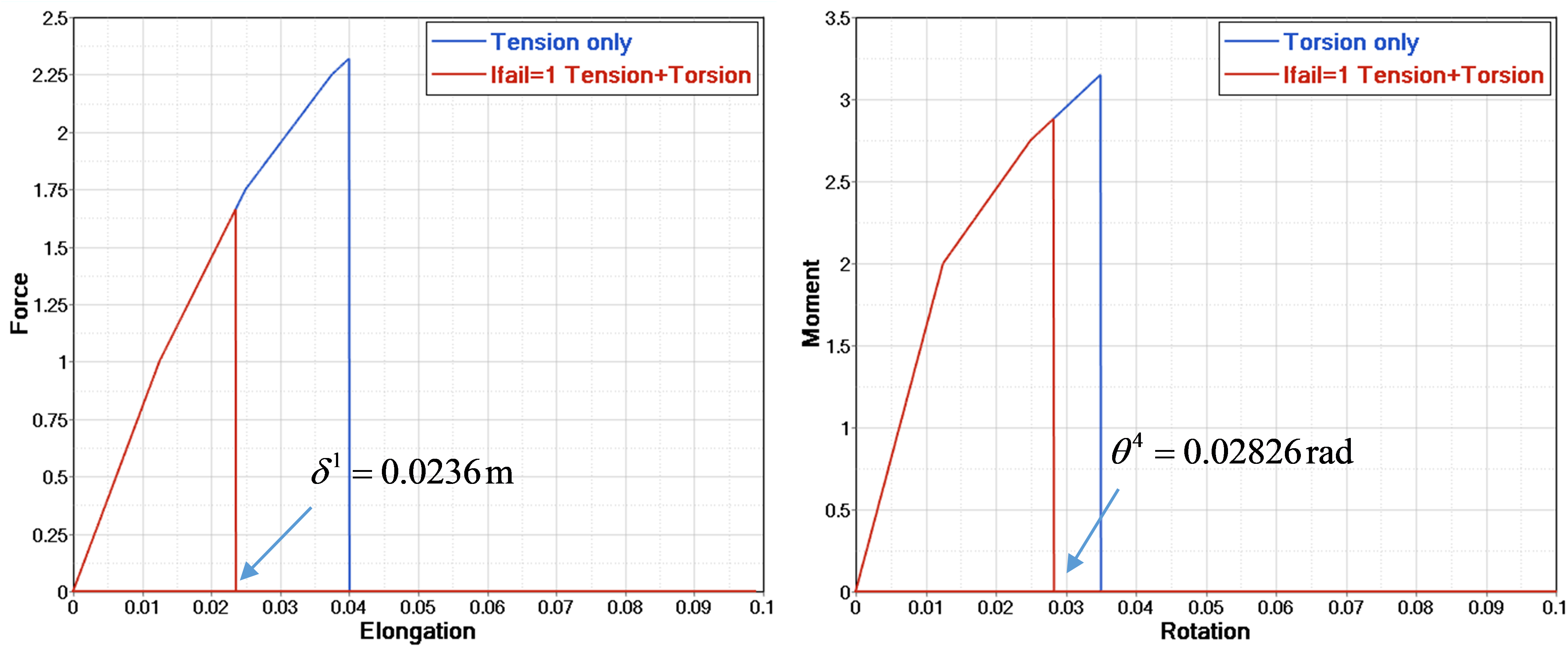

    In a test case of two load cases, tension + torsion and with Ifail = 1.
    Figure 5.

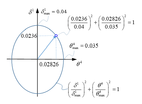

    Comparing the failure value against the limit set in just one direction, it usually is smaller than the defined limit. In this example case, the tension limit is set at 0.04m and torsion limit set at 0.035rad. The spring fails at an elongation 0.0236 < 0.04 and rotation 0.02826 < 0.035. This is because the failure combination of tension and torsion reaches the failure circle (Figure 6) and; therefore, the spring failed (force and moment fall to zero).
    Figure 6.

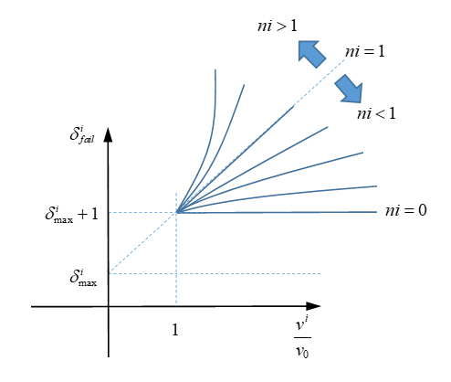

  • Displacement (or Rotation) Failure Criteria considering velocity effect (Ifail2 = 1)
    This failure criteria will allow model velocity dependent failure limits, they are available with displacement, force and internal energy. Therefore, translational δ i f a i l MathType@MTEF@5@5@+= feaagKart1ev2aaatCvAUfeBSjuyZL2yd9gzLbvyNv2CaerbuLwBLn hiov2DGi1BTfMBaeXatLxBI9gBaerbd9wDYLwzYbItLDharqqtubsr 4rNCHbGeaGqiVu0Je9sqqrpepC0xbbL8F4rqqrFfpeea0xe9Lq=Jc9 vqaqpepm0xbbG8FasPYRqj0=yi0dXdbba9pGe9xq=JbbG8A8frFve9 Fve9Ff0dmeaabaqaciGacaGaaeqabaWaaeaaeaaakeaacqaH0oazda ahaaWcbeqaaiaadMgaaaGcdaWgaaWcbaGaamOzaiaadggacaWGPbGa amiBaaqabaaaaa@3D04@ and rotational θ i f a i l MathType@MTEF@5@5@+= feaagKart1ev2aaatCvAUfeBSjuyZL2yd9gzLbvyNv2CaerbuLwBLn hiov2DGi1BTfMBaeXatLxBI9gBaerbd9wDYLwzYbItLDharqqtubsr 4rNCHbGeaGqiVu0Je9sqqrpepC0xbbL8F4rqqrFfpeea0xe9Lq=Jc9 vqaqpepm0xbbG8FasPYRqj0=yi0dXdbba9pGe9xq=JbbG8A8frFve9 Fve9Ff0dmeaabaqaciGacaGaaeqabaWaaeaaeaaakeaacqaH4oqCda ahaaWcbeqaaiaadMgaaaGcdaWgaaWcbaGaamOzaiaadggacaWGPbGa amiBaaqabaaaaa@3D15@ failure are modified to take into account velocity, as:(3)
    ∑ i = 1 , 2 , 3 ( δ i δ i f a i l ) 2 + ∑ i = 4 , 5 , 6 ( θ i θ i f a i l ) 2 ≥ 1 MathType@MTEF@5@5@+= feaagKart1ev2aaatCvAUfeBSjuyZL2yd9gzLbvyNv2CaerbuLwBLn hiov2DGi1BTfMBaeXatLxBI9gBaerbd9wDYLwzYbItLDharqqtubsr 4rNCHbGeaGqiVu0Je9sqqrpepC0xbbL8F4rqqrFfpeea0xe9Lq=Jc9 vqaqpepm0xbbG8FasPYRqj0=yi0dXdbba9pGe9xq=JbbG8A8frFve9 Fve9Ff0dmeaabaqaciGacaGaaeqabaWaaeaaeaaakeaadaaeqbqaam aabmaabaWaaSaaaeaacqaH0oazdaahaaWcbeqaaiaadMgaaaaakeaa cqaH0oazdaahaaWcbeqaaiaadMgaaaGcdaWgaaWcbaGaamOzaiaadg gacaWGPbGaamiBaaqabaaaaaGccaGLOaGaayzkaaaaleaacaWGPbGa eyypa0JaaGymaiaacYcacaaIYaGaaiilaiaaiodaaeqaniabggHiLd GcdaahaaWcbeqaaiaaikdaaaGccqGHRaWkdaaeqbqaamaabmaabaWa aSaaaeaacqaH4oqCdaahaaWcbeqaaiaadMgaaaaakeaacqaH4oqCda ahaaWcbeqaaiaadMgaaaGcdaWgaaWcbaGaamOzaiaadggacaWGPbGa amiBaaqabaaaaaGccaGLOaGaayzkaaaaleaacaWGPbGaeyypa0JaaG inaiaacYcacaaI1aGaaiilaiaaiAdaaeqaniabggHiLdGcdaahaaWc beqaaiaaikdaaaGccqGHLjYScaaIXaaaaa@6162@
    δ i f a i l = { δ max i + c i ⋅ | v i v 0 | n i ,      i f ( δ i > 0 ) δ min i − c i ⋅ | v i v 0 | n i ,      i f ( δ i ≤ 0 ) MathType@MTEF@5@5@+= feaagKart1ev2aaatCvAUfeBSjuyZL2yd9gzLbvyNv2CaerbuLwBLn hiov2DGi1BTfMBaeXatLxBI9gBaerbd9wDYLwzYbItLDharqqtubsr 4rNCHbGeaGqiVu0Je9sqqrpepC0xbbL8F4rqqrFfpeea0xe9Lq=Jc9 vqaqpepm0xbbG8FasPYRqj0=yi0dXdbba9pGe9xq=JbbG8A8frFve9 Fve9Ff0dmeaabaqaciGacaGaaeqabaWaaeaaeaaakeaacqaH0oazda ahaaWcbeqaaiaadMgaaaGcdaWgaaWcbaGaamOzaiaadggacaWGPbGa amiBaaqabaGccqGH9aqpdaGabaqaauaabeqaceaaaeaacqaH0oazda qhaaWcbaGaciyBaiaacggacaGG4baabaGaamyAaaaakiabgUcaRiaa dogadaWgaaWcbaGaamyAaaqabaGccqGHflY1daabdaqaamaalaaaba GaamODamaaCaaaleqabaGaamyAaaaaaOqaaiaadAhadaWgaaWcbaGa aGimaaqabaaaaaGccaGLhWUaayjcSdWaaWbaaSqabeaacaWGUbGaam yAaaaakiaacYcacaqGGaGaaeiiaiaabccacaqGGaGaamyAaiaadAga daqadaqaaiabes7aKnaaCaaaleqabaGaamyAaaaakiabg6da+iaaic daaiaawIcacaGLPaaaaeaacqaH0oazdaqhaaWcbaGaciyBaiaacMga caGGUbaabaGaamyAaaaakiabgkHiTiaadogadaWgaaWcbaGaamyAaa qabaGccqGHflY1daabdaqaamaalaaabaGaamODamaaCaaaleqabaGa amyAaaaaaOqaaiaadAhadaWgaaWcbaGaaGimaaqabaaaaaGccaGLhW UaayjcSdWaaWbaaSqabeaacaWGUbGaamyAaaaakiaacYcacaqGGaGa aeiiaiaabccacaqGGaGaamyAaiaadAgadaqadaqaaiabes7aKnaaCa aaleqabaGaamyAaaaakiabgsMiJkaaicdaaiaawIcacaGLPaaaaaaa caGL7baaaaa@7E9B@ and θ i f a i l = { θ max i + c i ⋅ | ω i ω 0 | n i ,      i f ( θ i > 0 ) θ min i − c i ⋅ | ω i ω 0 | n i ,      i f ( θ i ≤ 0 ) MathType@MTEF@5@5@+= feaagKart1ev2aaatCvAUfeBSjuyZL2yd9gzLbvyNv2CaerbuLwBLn hiov2DGi1BTfMBaeXatLxBI9gBaerbd9wDYLwzYbItLDharqqtubsr 4rNCHbGeaGqiVu0Je9sqqrpepC0xbbL8F4rqqrFfpeea0xe9Lq=Jc9 vqaqpepm0xbbG8FasPYRqj0=yi0dXdbba9pGe9xq=JbbG8A8frFve9 Fve9Ff0dmeaabaqaciGacaGaaeqabaWaaeaaeaaakeaacqaH4oqCda ahaaWcbeqaaiaadMgaaaGcdaWgaaWcbaGaamOzaiaadggacaWGPbGa amiBaaqabaGccqGH9aqpdaGabaqaauaabeqaceaaaeaacqaH4oqCda qhaaWcbaGaciyBaiaacggacaGG4baabaGaamyAaaaakiabgUcaRiaa dogadaWgaaWcbaGaamyAaaqabaGccqGHflY1daabdaqaamaalaaaba GaeqyYdC3aaWbaaSqabeaacaWGPbaaaaGcbaGaeqyYdC3aaSbaaSqa aiaaicdaaeqaaaaaaOGaay5bSlaawIa7amaaCaaaleqabaGaamOBai aadMgaaaGccaGGSaGaaeiiaiaabccacaqGGaGaaeiiaiaadMgacaWG MbWaaeWaaeaacqaH4oqCdaahaaWcbeqaaiaadMgaaaGccqGH+aGpca aIWaaacaGLOaGaayzkaaaabaGaeqiUde3aa0baaSqaaiGac2gacaGG PbGaaiOBaaqaaiaadMgaaaGccqGHsislcaWGJbWaaSbaaSqaaiaadM gaaeqaaOGaeyyXIC9aaqWaaeaadaWcaaqaaiabeM8a3naaCaaaleqa baGaamyAaaaaaOqaaiabeM8a3naaBaaaleaacaaIWaaabeaaaaaaki aawEa7caGLiWoadaahaaWcbeqaaiaad6gacaWGPbaaaOGaaiilaiaa bccacaqGGaGaaeiiaiaabccacaWGPbGaamOzamaabmaabaGaeqiUde 3aaWbaaSqabeaacaWGPbaaaOGaeyizImQaaGimaaGaayjkaiaawMca aaaaaiaawUhaaaaa@8238@
    The parameter c i MathType@MTEF@5@5@+= feaagKart1ev2aaatCvAUfeBSjuyZL2yd9gzLbvyNv2CaerbuLwBLn hiov2DGi1BTfMBaeXatLxBI9gBaerbd9wDYLwzYbItLDharqqtubsr 4rNCHbGeaGqiVu0Je9sqqrpepC0xbbL8F4rqqrFfpeea0xe9Lq=Jc9 vqaqpepm0xbbG8FasPYRqj0=yi0dXdbba9pGe9xq=JbbG8A8frFve9 Fve9Ff0dmeaabaqaciGacaGaaeqabaWaaeaaeaaakeaacaWGJbWaaS baaSqaaiaadMgaaeqaaaaa@3860@ is a scale of exponent function, and parameter n i MathType@MTEF@5@5@+= feaagKart1ev2aaatCvAUfeBSjuyZL2yd9gzLbvyNv2CaerbuLwBLn hiov2DGi1BTfMBaeXatLxBI9gBaerbd9wDYLwzYbItLDharqqtubsr 4rNCHbGeaGqiVu0Je9sqqrpepC0xbbL8F4rqqrFfpeea0xe9Lq=Jc9 vqaqpepm0xbbG8FasPYRqj0=yi0dXdbba9pGe9xq=JbbG8A8frFve9 Fve9Ff0dmeaabaqaciGacaGaaeqabaWaaeaaeaaakeaacaWGUbGaam yAaaaa@383F@ effects the failure as in Figure 7.
    Figure 7.
