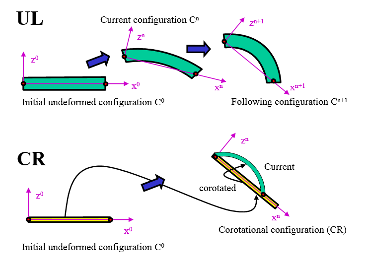

- Total Lagrangian description (TL)
- The FEM equations are formulated with respect to a fixed reference configuration which is not changed throughout the analysis. The initial configuration is often used; but in special cases the reference could be an artificial base configuration.
- Updated Lagrangian description (UL)
- The reference is the last known (accepted) solution. It is kept fixed over a step and updated at the end of each step.
- Corotational description (CR)
- The FEM equations of each element are referred to two systems. A fixed or base configuration is used as in TL to compute the rigid body motion of the element. Then the deformed current state is referred to the corotated configuration obtained by the rigid body motion of the initial reference.
Figure 1. Updated Lagrangian and Corotational Descriptions
