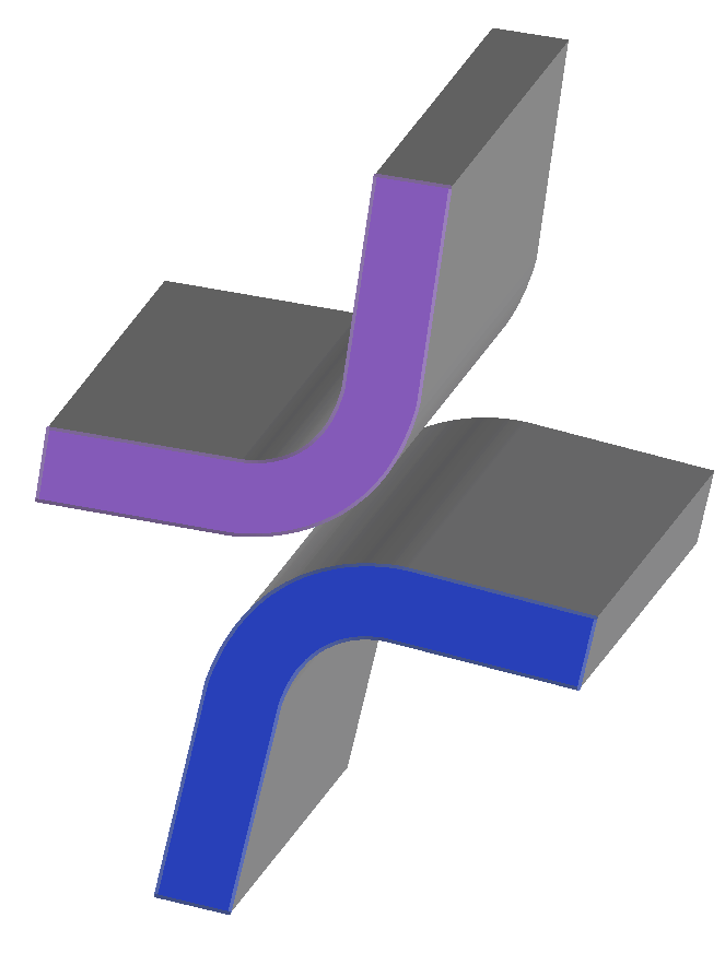

The interface is used in the modeling of surface-to-surface contact. It is a generalized form of
TYPE16 interface in which the contact on the two quadratic surfaces are directly
resolved without needs of gap as the Lagrange Multiplier Method is used (Figure 1). The contact is supposed
to be sliding or tied.
