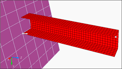

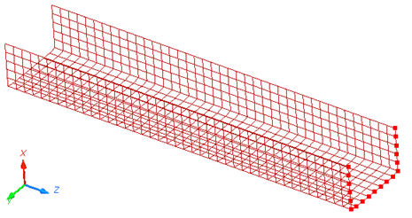

This tutorial simulates buckling of a tube using half tube mesh with symmetric boundary conditions.

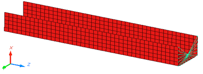

Figure 1. Model
The model description is as follows:
- UNITS: Length (mm), Time (ms), Mass (kg), Force (kN) and Stress (GPa)
- Simulation time: Engine [0 - 10 ms]
- The tube thickness is 0.914 mm.
- An imposed velocity of 13.3 mm/ms (~30 MPH) is applied to the right end of the tube
- Elasto plastic material using Johnson-Cook law /MAT/PLAS_JOHNS (STEEL).
[Rho_Initial] Initial density = 7.85e-6 Kg/mm3
[E] Young's modulus = 210 GPa
[nu] Poisson coefficient = 0.3
[a] Yield Stress = 0.206 GPa
[b] Hardening Parameter = 0.450 GPa
[n] Hardening Exponent = 0.5

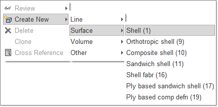

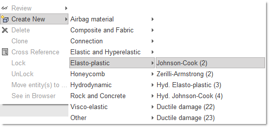

Create and Assign a Material
Create and Assign a Property

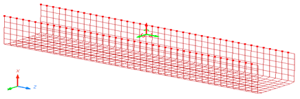

Define the Rigid Body
Define Boundary Conditions
Define Boundary Conditions Representing Symmetry

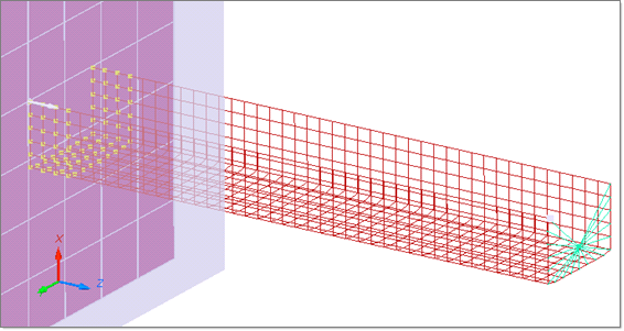

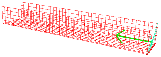

Define the Imposed Velocity
Define a Rigid Wall

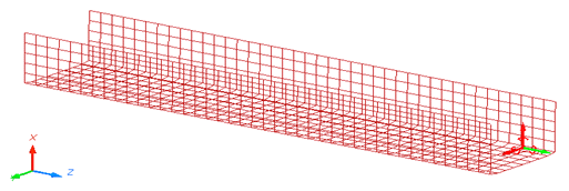

Create a Self Contact for the Tube

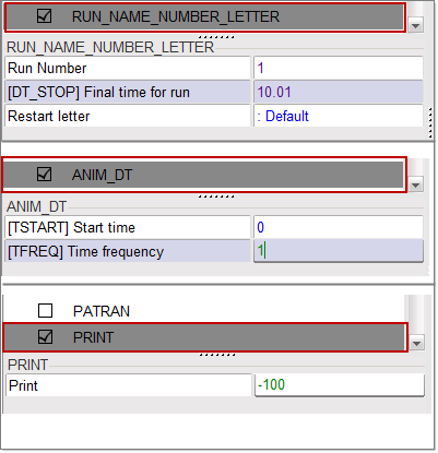

Export the Model

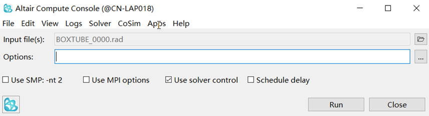

Open Compute Console from the Windows Start Menu

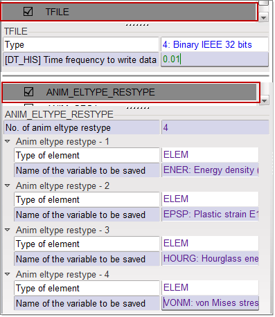

Figure 17.

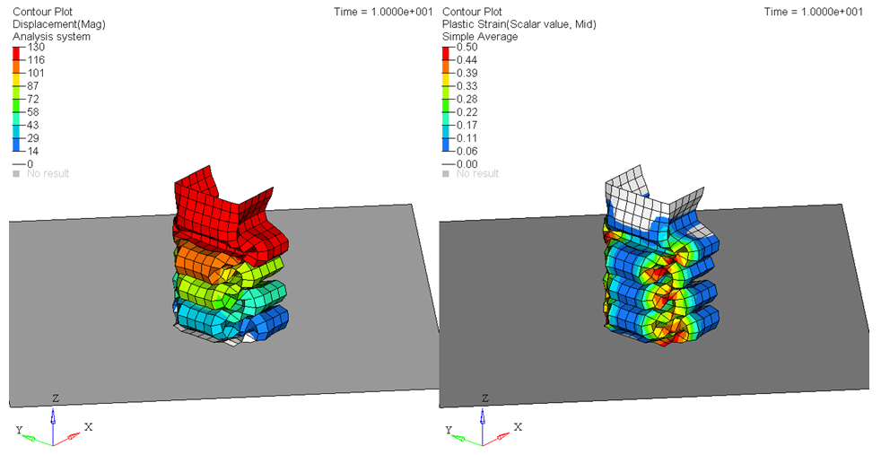

Review the Results
Figure 18.
