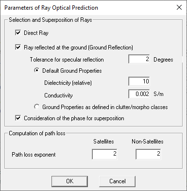

Settings
Figure 2. The Parameters of Ray Optical Prediction dialog.
- direct ray
- reflected ray with the following settings:
- tolerance for specular reflections
- default ground properties with electrical properties
- ground properties as defined in clutter / morpho table
