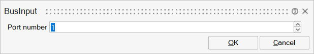

Placed in the diagram of a super block, the BusInput block adds a bus input port to the super block for connecting blocks outside of the super block to specified blocks inside of the super block. Any link, outside of the super block, connected to the bus input port extends to the corresponding BusInput block inside of the super block. The BusInput block supports regular signals in addition to bus signals.The parameter "Port number" determines the relationship between the port block and the port on the super block. By default, the input ports are numbered sequentially from top to bottom.
BusInput_0
portNumber
Port number
Number
