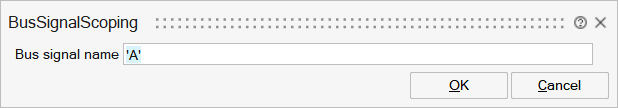

The BusSignalScoping block defines the accessibility of the SetBusSignal block when it is configured as "Scoped". The GetBusSignal block corresponding to the SetBusSignal must be in the same subsystem of the BusSignalScoping or in the subsystems below it in the model hierarchy.It's not needed for Local or Global scoping bus signals.The signal name can be any valid OML string.
BusSignalScoping_0
tag
Bus signal name
Specify the name of the bus signal.
String
