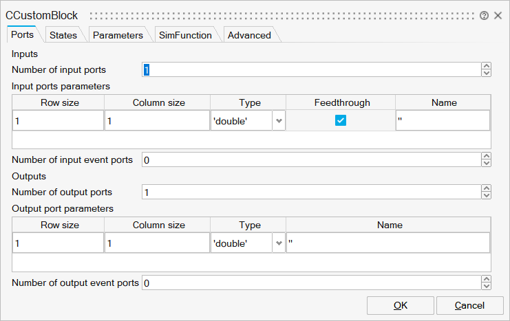

nin
Number of input ports
Number
inports
Input ports parameters
Structure
inports/inrow
Row size
Cell of scalars
inports/incol
Column size
Cell of scalars
inports/it
Type
Cell of strings
'double'
'complex'
'int64'
'int32'
'int16'
'int8'
'uint64'
'uint32'
'uint16'
'uint8'
'boolean'
'pointer'
'inherit'
inports/depu
Feedthrough
Cell of scalars
0
1
inports/name
Name
Cell of strings
nevin

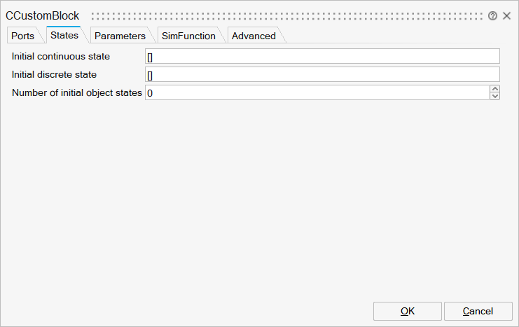

xx
Initial continuous state
Vector
xd
Initial state derivative
Vector
z
Initial discrete state
Vector
noz
Number of initial object states
Number
ozparams
Initial object states
Structure
ozparams/oztyp
Type
Cell of strings
'double'
'complex'
'int64'
'int32'
'int16'
'int8'
'uint64'
'uint32'
'uint16'
'uint8'
'int64'
'uint64'
'boolean'
ozparams/ozvalue
Value
Cell of matrices
ozparams/name
Name
Cell of strings
CCustomBlock_2

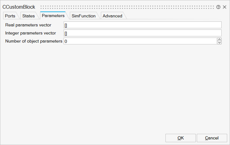

rpar
Real parameters vector
Vector
ipar
Integer parameters vector
Vector
nopar
Number of object parameters
Number
oparparams
Object parameters
Structure
oparparams/opartyp
Type
Cell of strings
'double'
'complex'
'int64'
'int32'
'int16'
'int8'
'uint64'
'uint32'
'uint16'
'uint8'
'boolean'
'int64'
'uint64'
'string'
oparparams/oparvalue
Value
oparparams/name
Name
Cell of strings
CCustomBlock_3

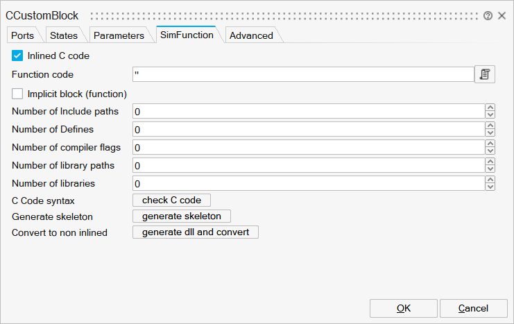

inlined
Inlined C code
Number
0
1
code
Function code
String
fcn
Function
Structure
fcn/slib
Shared library path
Cell of strings
fcn/epoint
Entry point
Cell of strings
impl
Implicit block (function)
Number
0
1
nincludepath
Number of Include paths
Number
includepath
Include paths
Structure
includepath/path
Include Path
Cell of strings
ndefine
Number of Defines
Number
define
Defines
Structure
define/path
Define
Cell of strings
ncompileflags
Number of compiler flags
Number
compileflags
Compiler Flags
Structure
compileflags/path
Compiler flag
Cell of strings
nlibpath
Number of library paths
Number
libpath
Library paths
Structure
libpath/path
Library path
Cell of strings
nlibs
Number of libraries
Number
libs
Libraries
Structure
libs/path
Library name
Cell of strings

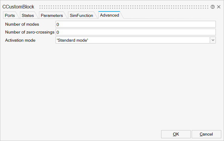

nmode
Number of modes
Scalar
nzcr
Number of zero-crossings
Scalar
dept
Activation mode
String
'Always
Active
mode'
'Initially
Active
mode'
'Standard
mode'
