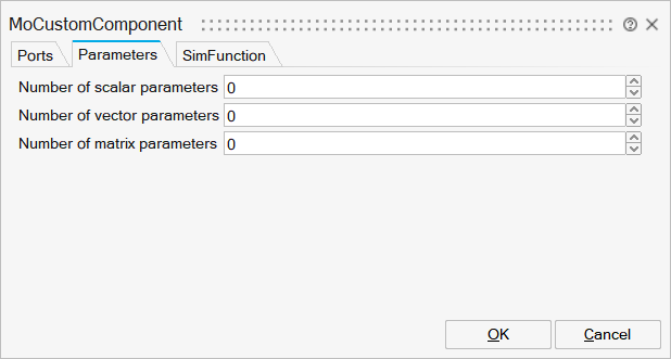

For the parameters, 3 options are offered in Modelica language:
"Fixed" means that this is a constant and cannot change during simulation. In Modelica, this is expressed as: Parameter Real R=1;
"Fixed only at initialization" means that this value can change during simulation, but when the compiler tried to find the initial value this value must not change. In Modelica, this is expressed as: Parameter Real R(start = 1,fixed=true);
"Variable" means that this value can change during the simulation and during the initialization phase. In Modelica, this is expressed as: Parameter Real R(start=1); or Parameter Real R(start=1,fixed=false);

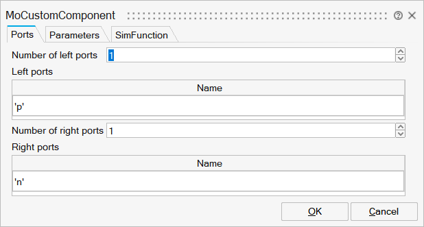

MoCustomComponent_0
nin
Number of left ports
Number
inports
Left ports
Structure
inports/name
Name
Cell of strings
nout
Number of right ports
Number
outports
Right ports
Structure
outports/name
Name
Cell of strings
MoCustomComponent_1
nparams
Number of scalar parameters
Number
params
Structure
params/name
Name
Cell of strings
params/value
Value
Cell of scalars
params/typ
Type
Cell of strings
'Fixed'
'Fixed
only
at
initialization'
'Variable'
nparamsvec
Number of vector parameters
Number
paramsvec
Structure
paramsvec/name
Name
Cell of strings
paramsvec/value
Value
Cell of vectors
paramsvec/typ
Type
Cell of strings
'Fixed'
'Fixed
only
at
initialization'
'Variable'
nparamsmat
Number of matrix parameters
Number
paramsmat
Structure
paramsmat/name
Name
Cell of strings
paramsmat/value
Value
Cell of matrices
paramsmat/typ
Type
Cell of strings
'Fixed'
'Fixed
only
at
initialization'
'Variable'

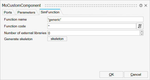

MoCustomComponent_2
codename
Function name
Name of the model as it appears in the Function code.
String
code
Function code
Modelica code describing the behavior of the component.
String
nlibs
Number of external libraries
Number
libs
Libs
Structure
libs/path
Lib name
Cell of strings
Port 1
implicit
output
nout
Port 2
implicit
input
nin
