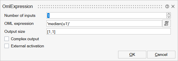

OmlExpression
The output of this block is obtained by evaluating the OML expression specified as a block parameter. The expression is evaluated at run time by the OML interpreter. The variable names u1,...un designate the block inputs in this expression (ui designates the ith input value; u may be used in place of u1). The expression may contain parameters defined in the contexts of the diagram, and functions and parameters defined in the OML environment when the model is simulated. Note that functions and parameters named u, u1, u2,..., will be shadowed by the input variables.
    OmlExpression
Activate/MathOperations
OmlExpression_0
nin
Number of inputs
Number of block inputs.
Number
work
Workspace Evaluation
exx
OML expression
OML expression that should be evaluated.
String
outsz
Output size
Size of the output in a matrix shape.
Vector of size 2
outtp
Complex output
Allows output to be of complex form, with real and imaginary parts.
Number
0
1
externalActivation
External activation
Specifies whether the block receives an external activation or inherits its activation through its regular input ports. When External Activation is selected, an additional activation port is added to the block. By default, external activation is not selected.
Number
0
1
