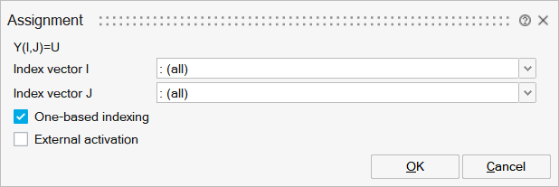

Assignment
Assigns value(s) to specified element(s) of the input matrix.
    Assignment
Activate/MatrixOperations
Specified elements of input matrix is assigned with the input labeled 'u'. The specified rows or columns can either be represented by a vector of row/column numbers as the block parameter, or fed externally with an optional input.

Index vector I
Index selection method for the first dimension.

assigny
Index vector J
Index selection method for the second dimension.

onebased
One-based indexing
To index a matrix, start from one when checked, start from zero when unchecked.
Number
0
1
externalActivation
External activation
Specifies whether the block receives an external activation or inherits its activation through its regular input ports. When External Activation is selected, an additional activation port is added to the block. By default, external activation is not selected.
