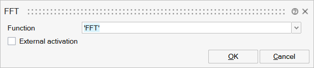

direction
Function
Function that is applied to the input vector/matrix. The choices are FFT or IFFT (inverse FFT).
String
'FFT'
'IFFT'

externalActivation
External activation
Specifies whether the block receives an external activation or inherits its activation through its regular input ports. When External Activation is selected, an additional activation port is added to the block. By default, external activation is not selected.
