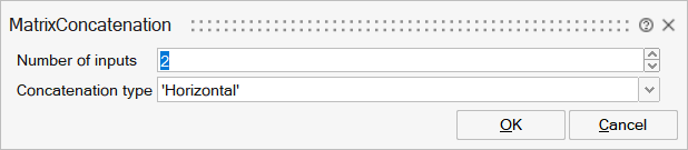

The MatrixConcatenation block, depending on the selection of the Concatenation Type parameter, performs either Horizontal or Vertical concatenation. The horizontal concatenation of multiple matrices, also called concatenation according to the columns, applies to inputs U1,U2,...,Un with the same number of rows. The output is a M-by-(N1+N2+...+Nn) matrix, where N1,N2,...,Nn are the numbers of columns of the inputs matrices, and M is the number of rows. The vertical concatenation of multiple matrices, also called concatenation according to the rows, applies to inputs U1,U2,...,Un with the same number of columns. The output is a (M1+M2+...+Mn)-by-N matrix, where M1,M2,...,Mn are the numbers of rows of the inputs matrices, and N is the number of columns.
MatrixConcatenation_0
nin
Number of inputs
Number of block inputs.
Number
method
Concatenation type
Dimension through which the concatenation will take place. default: horizontal.
String
'Horizontal'
'Vertical'
