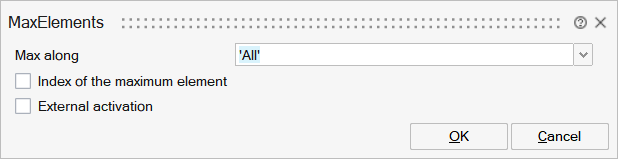

This block computes the maximum of the elements of an input matrix/vector. Based on the Max Along parameter, the output is either a scalar, a row vector or a column vector. When "Max along" is set to "All", the maximum matrix element is outputted. When "Max along" is set to "Rows", maximum element in each row is outputted, results in a column vector. When "Max along" is set to "Columns", maximum element in each column is outputted, results in a row vector.
MaxElements_0
decomptyp
Max along
Specify how the maximum is computed in given matrix.
String
'All'
'Rows'
'Columns'
mindex
Index of the maximum element
This parameter defines if the block returns the index of the maximum element in the input.
Number
0
1
