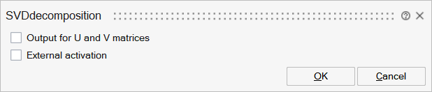

decomptyp
Output for U and V matrices
Defines the outputs. By default, the output is a vector S, composed of the singular values.Turning on this parameter, the first output is a diagonal matrix S composed of the singular values and the other two outputs are the unitary matrices U and V.

externalActivation
External activation
Specifies whether the block receives an external activation or inherits its activation through its regular input ports. When External Activation is selected, an additional activation port is added to the block. By default, external activation is not selected.
