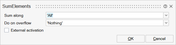

When the Sum along parameter is set to all, the block outputs the sum of all the elements of the matrix. The output is then a scalar.
When the Sum along parameter is set to Rows the block performs a row-wise sum. The output is a column vector.
When the Sum along is set to Columns, the block is a column-wise sum. The output is a row vector.
SumElements_0
decomptyp
Sum along
Dimension in which the sum will be computed. Default: all (sum of all the elements of the matrix).
