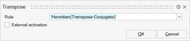

Transpose_0
rule
Rule
Method to transpose the matrix. Default: Hermitian (transpose of the conjugate).
String
'Transpose'
'Hermitian(Transpose-Conjugate)'
