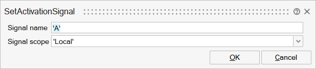

SetActivationSignal
This block sends output activations to a corresponding GetActivationSignal block by connecting the event ports of the blocks without using a link. A single SetActivationSignal block can send activations to multiple GetActivationSignal blocks, but a GetActivationSignal block can receive activation from only one SetActivationSignal block.
    SetActivationSignal
Activate/Routing
The SetActivationSignal block connects event ports from one block to another without connecting them physically. It is used with a GetActivationSignal block. A simple SetActivationSignal block can send activation to multiple GetActivationSignal, although a GetActivationSignal can receive activation from only one SetActivationSignal. SetActivationSignal transports its input activation to its corresponding GetActivationSignal block.
The "Signal Scope" parameter defines the scope in which the implicit signal is defined. For more information, please refer to the GetSignal block.
SetActivationSignal_0
tag
Signal name
Signal name.
String
tagvis
Signal scope
Scope of the given signal. Default: local.
String
'Local'
'Scoped'
'Global'
Port 1
activation
input
1
