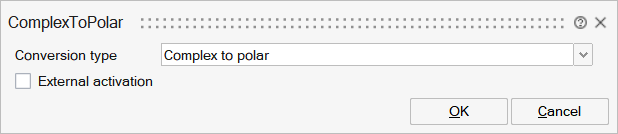

The ComplexToPolar block works in two ways. Given a complex matrix, the block computes its polar representation in which the magnitude and the angle are the two real outputs. Conversely, the block creates a complex matrix from a real matrix of magnitudes and a real matrix of angles. Conversely, the block creates a complex matrix from a real matrix of magnitudes and a real matrix of angles. The decomposition type parameter defines the behavior of the blocks.
ComplexToPolar_0
decomptyp
Conversion type
This parameter defines the decomposition type.
Structure
decomptyp/CtoP
Complex to polar
The block has a complex matrix as input and produces two real matrices as output.
Number
1
2
decomptyp/PtoC
Polar to complex
The block has two real matrices as input (magnitude and angle) and produces a complex matrix as output.
Number
1
2
externalActivation
External activation
Specifies whether the block receives an external activation or inherits its activation through its regular input ports. When External Activation is selected, an additional activation port is added to the block. By default, external activation is not selected.
Number
0
1
