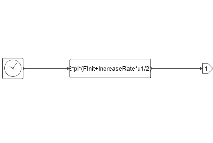

This block generates a variable frequency sinewave. Initial frequency and its variation across time (Increase rate) are specified as block parameters.
The frequency is changing linearly starting from Initial frequency and increases with the Increase rate.If we denote F the Initial frequency and R the Increase rate, the output of the block is computed as follows:Sin(2*PI*(F+R*time/2)*time)

Diagram
VariableFreqSine
