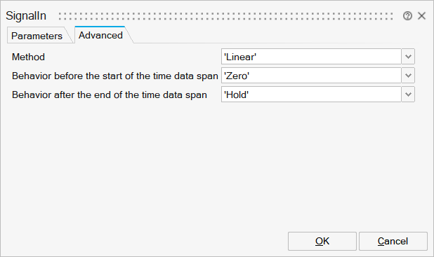

The variable provides the values of a signal V(i), at different time instants T(i). The value of the signal at times other than elements of T(i) are computed via interpolation or extrapolation. Several interpolation methods are available:"ZeroOrder", "Linear", "Not_a_knot", "Natural", and "Clamped_To_Zero".
"ZeroOrder": The element in T(i) which is the nearest and below the current time is gievn at the output, i.e.,
"Linear". This is the default method and performs a linear interpolation. If the time matches one of T elements, the output is the corresponding element in the V matrix. If no value matches the block's input, then the block performs linear interpolation between the two appropriate elements of the table to determine the output value, i.e.,
"Not_a_knot": A cubic spline is computed and used by imposing the following conditions (considering N points T(1),...,T(N)) :
"Natural": A cubic spline is computed and used by imposing the following conditions (considering N points T(1),...,T(N)) :
"Clamped_To_Zero": A cubic spline is computed and used by imposing the following conditions (considering N points T(1),...,T(N)) :
The value of the signal at time instants out of the range [T(1), T(N)] are computed via extrapolation. Several extrapolation methods are available: "Zero", "Hold", "Extrapolation", and "Repeat".
"Zero":This is the default method. In this case, the output is zero for time instants out of signal's range, i.e.,
"Hold": The output is equal to the last element of the V vector, i.e.,
"Extrapolation". The block performs linear extrapolation using two last elements of the signal, i.e.,
"Repeat". The signal is repeated over the whole range.

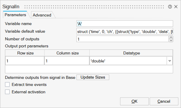

varnam | Variable name | Name of the variable in the OML workspace. | String | |
defvalue | Variable default value | Value used in case the variable is not defined in the OML workspace. | ||
nout | Number of outputs | Number of outputs, equal to the number of channels in the cell "ch". | Number | |
outports | Output port parameters | Structure | ||
outports/outrow | Row size | Cell of scalars | ||
outports/outcol | Column size | Cell of scalars | ||
outports/ot | Datatype | Cell of strings | 'double' | |
outevent | Extract time events | This parameter defines if the block generates an activation event. When OutEvent is used, a additional event output port is added to the block. default is OFF. | Scalar | 0 |
externalActivation | External activation | This parameter defines if the block receives an external activation or inherits. When External Activation is used, a additional activation port is added to the block. default is OFF. | Number | 0 |
Method | Method | String | 'ZeroOrder' | |
Leftside | Behavior before the start of the time data span | String | 'Zero' | |
Rightside | Behavior after the end of the time data span | String | 'Zero' |
