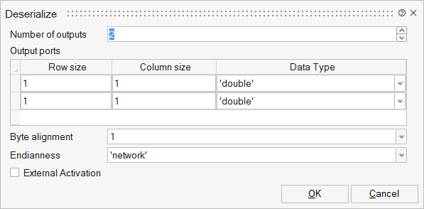

The deserialize block generates outputs of different types and sizes based on block parameters Endianness and alignment.
Deserialize_0
nout
Number of outputs
Defines the number of outputs of the block.
Number
outports
Output ports
Defines the data type and size for each port.
Structure
outports/rowsize
Row size
Defines the row size for each output port
Cell of scalars
outports/colsize
Column size
Defines the column size for each output port
Cell of scalars
outports/datatype
Data Type
Defines the data type for each output port
Cell of strings
'double'
'int32'
'int16'
'int8'
'uint32'
'uint16'
'uint8'
'boolean'
align
Byte alignment
Defines the number of bit shifts
Scalar
1
2
4
8
mode
Endianness
Defines the Endianness mode. Network is always big endian.
String
'host'
'network'
externalActivation
External Activation
This parameter defines if the block receives an external activation or inherits. When External Activation is used, a additional activation port is added to the block. default is OFF.
Number
0
1
