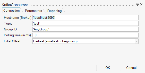

KafkaConsumer_0
hostname
Hostname (Broker)
Defines the broker's IP address
String
topic
Topic
Defines the topic to describe to, the message will be read from that topic. The messages are stored at this topic.
String
groupid
Group ID
Specifies the consumer group to which the Kafka Consumer instance belongs.
String
polltime
Polling time (in ms)
Specifies the maximum time to wait for consumer messages or events. If no records are received before this time expires, Kafka Consumer block returns an empty record set.
Scalar
Offset
Initial Offset
Defines the offset on startup.
Structure
Offset/earliest
Earliest (smallest or beginning)
automatically reset the offset to the smallest offset
Number
0
1
Offset/latest
Latest (largest or end)
automatically reset the offset to the largest offset
Number
0
1

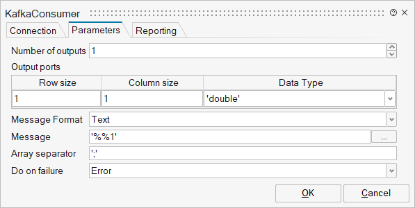

KafkaConsumer_1
nout
Number of outputs
Defines the number of outputs
Number
outports
Output ports
Defines the data type and size for each output.
Structure
outports/rowsize
Row size
Defines the row size for each output.
Cell of scalars
outports/colsize
Column size
Defines the column size for each output.
Cell of scalars
outports/datatype
Data Type
Defines the data type for each output.
Cell of strings
'double'
'int32'
'int16'
'int8'
'uint32'
'uint16'
'uint8'
'boolean'
messageformat
Message Format
Defines the Format of the message.
Structure
messageformat/text
Text
Number
0
1
messageformat/json
Json
Number
0
1
message
Message
Defines the message format to be read. This message can be of any format (text, JSON, ...). User can use %%1, %%2, ..., %%n to identify the outputs.
String
jsonfields
Json field names
Structure
jsonfields/name
Name
Cell of strings
separator
Array separator
Defines the separator used for arrays elements.
String
onFailure
Do on failure
Defines the behavior on failure.
Structure
onFailure/error
Error
Number
0
1
onFailure/warning
Warning
Number
0
1
onFailure/nothing
Nothing
Number
0
1

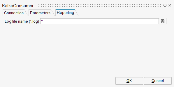

KafkaConsumer_2
log_file_name
Log file name (*.log)
Activate messages are logged into this file. the filename can be 'stderr' or 'stdout'.
String
