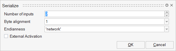

The serialize block generates a vector of type unit8 from inputs of different types and sizes based on block parameters Endianness and alignment.
Serialize_0
nin
Number of inputs
Defines the number of inputs of the block.
Number
align
Byte alignment
Defines the number of bit shifts
Scalar
1
2
4
8
mode
Endianness
Defines the Endianness mode. Network is always big endian.
String
'host'
'network'
externalActivation
External Activation
This parameter defines if the block receives an external activation or inherits. When External Activation is used, a additional activation port is added to the block. default is OFF.
Number
0
1
