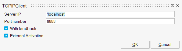

TCPIPClient
This block creates a TCP/IP client and connects to a server.
    TCPIPClient
Communicate
This block sends the input vector of type uint8 as a TCP/IP packet to the specified IP address and port number.
TCPIPClient_0
host
Server IP
Defines the server's IP address
String
port
Port number
Defines the port number to use
Scalar
nout
With feedback
If set, an output is added for establishing a feedback connection.
Number
0
1
externalActivation
External Activation
This parameter defines if the block receives an external activation or inherits. When External Activation is used, a additional activation port is added to the block. default is OFF.
Number
0
1
Port 1
explicit
output
nout
Port 2
explicit
input
1
Port 3
activation
input
externalActivation
