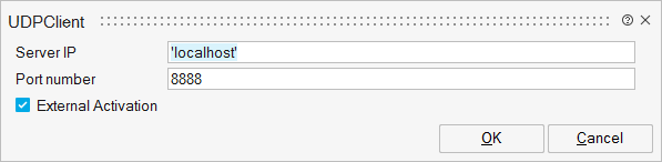

host
Server IP
Defines the server's IP address
String
port
Port number
Defines the port number to use
Scalar
externalActivation
External Activation
This parameter defines if the block receives an external activation or inherits. When External Activation is used, a additional activation port is added to the block. default is OFF.
