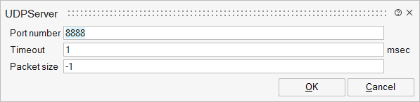

UDPServer_0
port
Port number
Defines the port number to use
Scalar
timeout
Timeout
Defines the timeout period in milli seconds
Scalar
sz
Packet size
Defines the packet size. If set to -1, it is computed automatically.
Scalar
