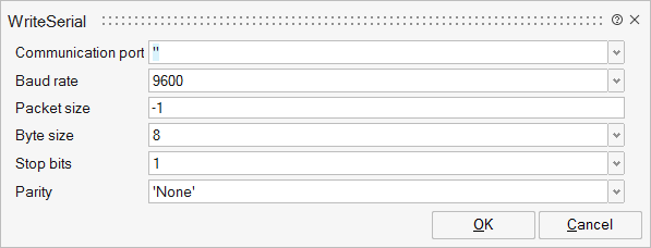

WriteSerial
This block writes data to the serial port
    WriteSerial
Communicate
WriteSerial_0
port
Communication port
Defines the communication port used for serial communication.
String
baudrate
Baud rate
Defines the speed of the communication. It should be match the one on the device.
Scalar
300
1200
2400
4800
9600
19200
38400
57600
115200
230400
460800
921600
packetSize
Packet size
Defines the packet size. If set to -1, it is computed automatically.
Scalar
bytesize
Byte size
Defines the number of data bits in each character.
Scalar
5
6
7
8
stopbit
Stop bits
Defines the number of stop bits sent at the end of every character. This allows the receiving signal hardware to resynchronise with the stream.
Scalar
1
1.5
2
parity
Parity
Defines the parity method used for the communication.
String
'None'
'Odd'
'Even'
