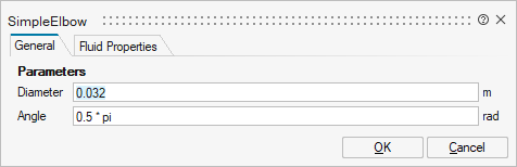

mo_Diameter | Diameter | Diameter | Scalar | |
mo_Angle | Angle | Elbow angle | Scalar |

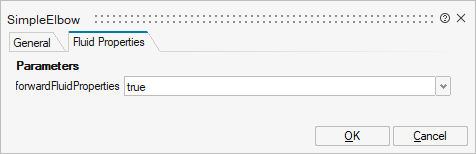

mo_forwardFluidProperties | forwardFluidProperties | Forward fluid properties between ports | Scalar | true |
