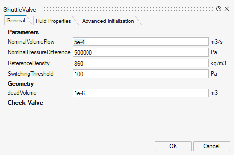

The component ShuttleValve is the model of a changeover valve with Dead volume at each port. It connects port C (the middle port) with the port that has the highest pressure. The flow characteristic is represented by an orifice.
SwitchingThreshold defines deadband to avoid chattering. The shuttle valve switches from A to B when
pressure A > (pressure B + SwitchingThreshold)
and switches from B to A when
pressure A < (pressure B - SwitchingThreshold)
A typical application of this valve is in a load sensing system to determine the highest load pressure.
Note: Due to small volumes between the ShuttleValve and connected components and switching action, a very high numerical stiffness may occur, resulting in small step sizes.
mo_NominalVolumeFlow | NominalVolumeFlow | Nominal volume flow | Scalar | |
mo_NominalPressureDifference | NominalPressureDifference | Nominal pressure difference | Scalar | |
mo_ReferenceDensity | ReferenceDensity | Reference density for volume flow and pressure difference | Scalar | |
mo_SwitchingThreshold | SwitchingThreshold | Pressure threshold to switch between ports | Scalar | |
mo_deadVolume | deadVolume | Dead volume at ports | Scalar | |

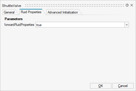

mo_forwardFluidProperties | forwardFluidProperties | Forward fluid properties between ports | Scalar | true |

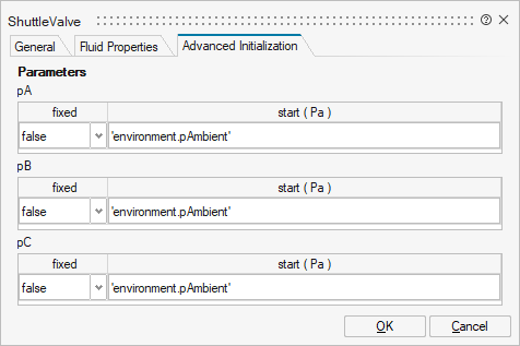

mo_pA/start | start | Cell of scalars | ||
mo_pB | pB | pB | Structure | |
mo_pB/fixed | fixed | Cell of scalars | true | |
mo_pB/start | start | Cell of scalars | ||
mo_pC | pC | pC | Structure | |
mo_pC/fixed | fixed | Cell of scalars | true | |
mo_pC/start | start | Cell of scalars |
