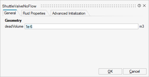

The component ShuttleValveNoFlow is the model of a changeover valve that has no flow through the valve, but only transmits the pressure. It connects port C (the middle port) with the port that has the highest pressure.
A typical application of this valve is in a load sensing system to determine the highest load pressure.

mo_deadVolume | deadVolume | Dead volume at ports | Scalar |
mo_forwardFluidProperties | forwardFluidProperties | Forward fluid properties between ports | Scalar | true |

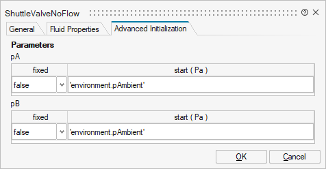

mo_pA/start | start | Cell of scalars | ||
mo_pB | pB | pB | Structure | |
mo_pB/fixed | fixed | Cell of scalars | true | |
mo_pB/start | start | Cell of scalars |
