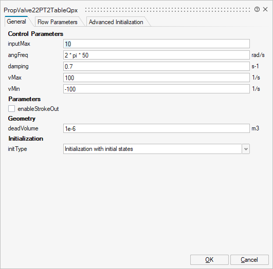

The component PropValve22PT2TableQpx is a model of a 2-way proportional valve where the stroke follows the input signal with a 2nd order delay.

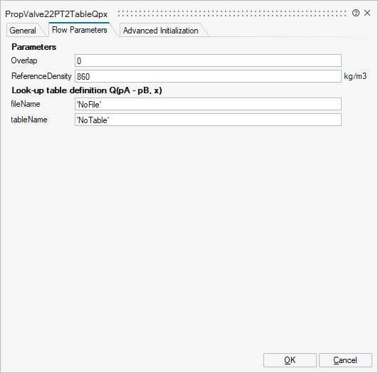

The hydraulic parameterization of the meetering edge is done by providing a look-up table of the flow rate as a function of the pressure drop and the input signal. Further information regarding the formatting of the look-up table can be found in the documentation of the component ResistorTableQpx.
For a positive stroke, the flow rate is increased with increasing input signal starting from 0 to Input value for 100 % open with maximum flow corresponding to an input value of Input value for 100 % open.
The valve stroke can be shifted by Relative overlap general. In accordance with common valve parameters a negative overlap will open the valve edge.
mo_inputMax | inputMax | Input value for 100 % open | Scalar | |
mo_angFreq | angFreq | Angular frequency | Scalar | |
mo_damping | damping | Damping | Scalar | |
mo_vMax | vMax | max. Velocity | Scalar | |
mo_vMin | vMin | min. Velocity | Scalar | |
mo_enableStrokeOut | enableStrokeOut | Enable Stroke Output | Number | 0 |
mo_inputMaxPartial | inputMaxPartial | Scalar | ||
mo_deadVolume | deadVolume | Dead volume at ports | Scalar | |
mo_initType | initType | Type of initialization (1: no init, 2: steady state, 3/4: initial output) | Structure | |
mo_initType/choice1 | No initialization (start values are used as guess values with fixed=false) | Number | 0 | |
mo_initType/choice2 | Steady state initialization (derivatives of states are zero) | Number | 0 | |
mo_initType/choice3 | Initialization with initial states | Number | 0 | |
mo_initType/choice4 | Initialization with initial outputs (and steady state of the states if possible) | Number | 0 |
mo_Overlap | Overlap | Valve edge relative overlap | Scalar | |
mo_ReferenceDensity | ReferenceDensity | Reference density | Scalar | |
mo_QFactorPA | QFactorPA | Factor for edge specific flow adjustment | Scalar | |
mo_fileName | fileName | File where look-up table is stored | String | |
mo_tableName | tableName | Table name on file | String |

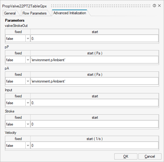

mo_valveStrokeOut | valveStrokeOut | valveStrokeOut | Structure | |
mo_valveStrokeOut/fixed | fixed | Cell of scalars | true | |
mo_valveStrokeOut/start | start | Cell of scalars | ||
mo_pP | pP | pP | Structure | |
mo_pP/fixed | fixed | Cell of scalars | true | |
mo_pP/start | start | Cell of scalars | ||
mo_pA/start | start | Cell of scalars | ||
mo_Input | Input | Input | Structure | |
mo_Input/fixed | fixed | Cell of scalars | true | |
mo_Input/start | start | Cell of scalars | ||
mo_Stroke | Stroke | Stroke | Structure | |
mo_Stroke/fixed | fixed | Cell of scalars | true | |
mo_Stroke/start | start | Cell of scalars | ||
mo_Velocity | Velocity | Velocity | Structure | |
mo_Velocity/fixed | fixed | Cell of scalars | true | |
mo_Velocity/start | start | Cell of scalars |
