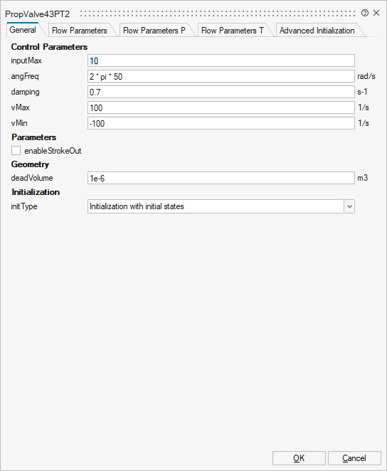

mo_inputMax | inputMax | Input value for 100 % open | Scalar | |
mo_angFreq | angFreq | Angular frequency | Scalar | |
mo_damping | damping | Damping | Scalar | |
mo_vMax | vMax | max. Velocity | Scalar | |
mo_vMin | vMin | min. Velocity | Scalar | |
mo_enableStrokeOut | enableStrokeOut | Enable Stroke Output | Number | 0 |
mo_inputMaxPartial | inputMaxPartial | Scalar | ||
mo_forwardFluidPropertiesBT | forwardFluidPropertiesBT | Scalar | true | |
mo_eps | eps | Scalar | ||
mo_deadVolume | deadVolume | Dead volume at ports | Scalar | |
mo_initType | initType | Type of initialization (1: no init, 2: steady state, 3/4: initial output) | Structure | |
mo_initType/choice1 | No initialization (start values are used as guess values with fixed=false) | Number | 0 | |
mo_initType/choice2 | Steady state initialization (derivatives of states are zero) | Number | 0 | |
mo_initType/choice3 | Initialization with initial states | Number | 0 | |
mo_initType/choice4 | Initialization with initial outputs (and steady state of the states if possible) | Number | 0 |

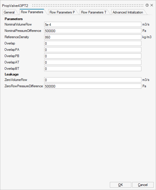

mo_NominalVolumeFlow | NominalVolumeFlow | Nominal volume flow | Scalar | |
mo_NominalPressureDifference | NominalPressureDifference | Nominal pressure difference | Scalar | |
mo_ReferenceDensity | ReferenceDensity | Reference density for volume flow and pressure difference | Scalar | |
mo_Overlap | Overlap | Valve edge general relative overlap | Scalar | |
mo_OverlapPA | OverlapPA | Valve edge PA relative overlap | Scalar | |
mo_OverlapPB | OverlapPB | Valve edge PB relative overlap | Scalar | |
mo_OverlapAT | OverlapAT | Valve edge AT relative overlap | Scalar | |
mo_OverlapBT | OverlapBT | Valve edge BT relative overlap | Scalar | |
mo_ZeroVolumeFlow | ZeroVolumeFlow | Volume flow due to leakage | Scalar | |
mo_ZeroFlowPressureDifference | ZeroFlowPressureDifference | Pressure difference for leakage flow | Scalar |

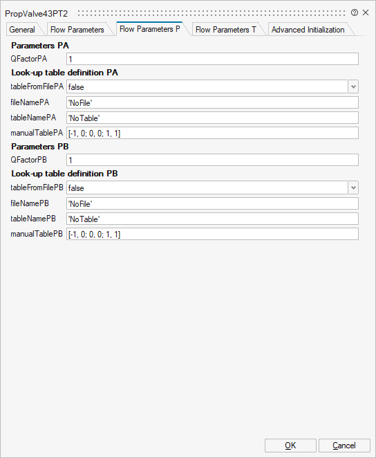

mo_QFactorPA | QFactorPA | Factor for edge PA specific flow adjustment | Scalar | |
mo_tableFromFilePA | tableFromFilePA | Table is provided by file | Scalar | true |
mo_fileNamePA | fileNamePA | File where look-up table is stored | String | |
mo_tableNamePA | tableNamePA | Table name on file | String | |
mo_manualTablePA | manualTablePA | Manually provided look-up table | Matrix | |
mo_QFactorPB | QFactorPB | Factor for edge PB specific flow adjustment | Scalar | |
mo_tableFromFilePB | tableFromFilePB | Table is provided by file | Scalar | true |
mo_fileNamePB | fileNamePB | File where look-up table is stored | String | |
mo_tableNamePB | tableNamePB | Table name on file | String | |
mo_manualTablePB | manualTablePB | Manually provided look-up table | Matrix |

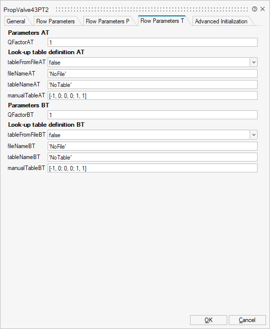

mo_QFactorAT | QFactorAT | Factor for edge AT specific flow adjustment | Scalar | |
mo_tableFromFileAT | tableFromFileAT | Table is provided by file | Scalar | true |
mo_fileNameAT | fileNameAT | File where look-up table is stored | String | |
mo_tableNameAT | tableNameAT | Table name on file | String | |
mo_manualTableAT | manualTableAT | Manually provided look-up table | Matrix | |
mo_QFactorBT | QFactorBT | Factor for edge BT specific flow adjustment | Scalar | |
mo_tableFromFileBT | tableFromFileBT | Table is provided by file | Scalar | true |
mo_fileNameBT | fileNameBT | File where look-up table is stored | String | |
mo_tableNameBT | tableNameBT | Table name on file | String | |
mo_manualTableBT | manualTableBT | Manually provided look-up table | Matrix |
