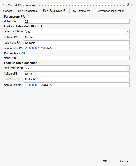

mo_alphaDPA | alphaDPA | Flow coefficient alphaD | Scalar | |
mo_tableFromFilePA | tableFromFilePA | Table is provided by file | Scalar | true |
mo_fileNamePA | fileNamePA | File where look-up table is stored | String | |
mo_tableNamePA | tableNamePA | Table name on file | String | |
mo_manualTablePA | manualTablePA | Manually provided look-up table | Matrix | |
mo_alphaDPB | alphaDPB | Flow coefficient alphaD | Scalar | |
mo_tableFromFilePB | tableFromFilePB | Table is provided by file | Scalar | true |
mo_fileNamePB | fileNamePB | File where look-up table is stored | String | |
mo_tableNamePB | tableNamePB | Table name on file | String | |
mo_manualTablePB | manualTablePB | Manually provided look-up table | Matrix |

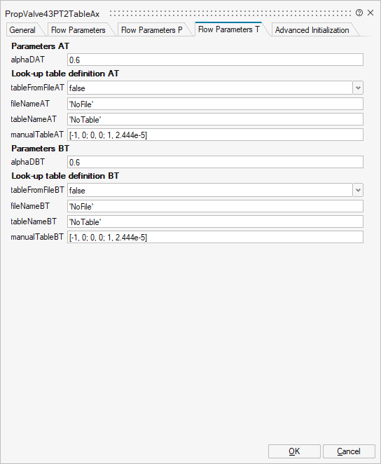

mo_alphaDAT | alphaDAT | Flow coefficient alphaD | Scalar | |
mo_tableFromFileAT | tableFromFileAT | Table is provided by file | Scalar | true |
mo_fileNameAT | fileNameAT | File where look-up table is stored | String | |
mo_tableNameAT | tableNameAT | Table name on file | String | |
mo_manualTableAT | manualTableAT | Manually provided look-up table | Matrix | |
mo_alphaDBT | alphaDBT | Flow coefficient alphaD | Scalar | |
mo_tableFromFileBT | tableFromFileBT | Table is provided by file | Scalar | true |
mo_fileNameBT | fileNameBT | File where look-up table is stored | String | |
mo_tableNameBT | tableNameBT | Table name on file | String | |
mo_manualTableBT | manualTableBT | Manually provided look-up table | Matrix |

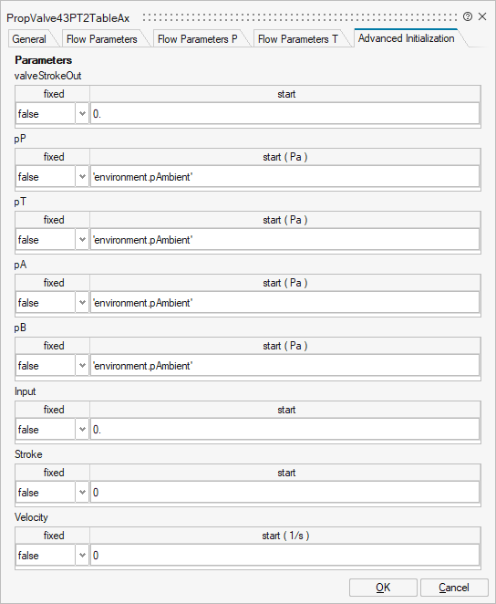

mo_valveStrokeOut | valveStrokeOut | valveStrokeOut | Structure | |
mo_valveStrokeOut/fixed | fixed | Cell of scalars | true | |
mo_valveStrokeOut/start | start | Cell of scalars | ||
mo_pP | pP | pP | Structure | |
mo_pP/fixed | fixed | Cell of scalars | true | |
mo_pP/start | start | Cell of scalars | ||
mo_pT | pT | pT | Structure | |
mo_pT/fixed | fixed | Cell of scalars | true | |
mo_pT/start | start | Cell of scalars | ||
mo_pA/start | start | Cell of scalars | ||
mo_pB | pB | pB | Structure | |
mo_pB/fixed | fixed | Cell of scalars | true | |
mo_pB/start | start | Cell of scalars | ||
mo_Input | Input | Input | Structure | |
mo_Input/fixed | fixed | Cell of scalars | true | |
mo_Input/start | start | Cell of scalars | ||
mo_Stroke | Stroke | Stroke | Structure | |
mo_Stroke/fixed | fixed | Cell of scalars | true | |
mo_Stroke/start | start | Cell of scalars | ||
mo_Velocity | Velocity | Velocity | Structure | |
mo_Velocity/fixed | fixed | Cell of scalars | true | |
mo_Velocity/start | start | Cell of scalars |
