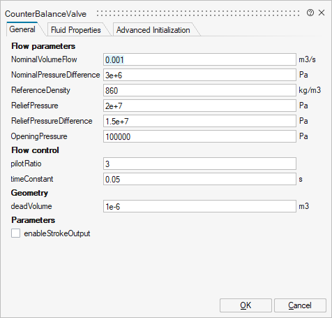

The flow characteristic of fully opened valve is given by parameters Nominal volume flow and Nominal pressure difference.
Relief and pilot performance diagram gives the parameters Relief pressure A->B and Relief pressure difference A->B.
Pilot ratio is one the main characteristics of a counter balance valve and is given in the data sheet.
Opening pressure difference B->A is a characteristics parameter of the check valve for reverse flow. It can be determined also from free flow diagram. In the presented diagram the opening pressure difference is very small. Typically, values are around 1 bar.

mo_NominalVolumeFlow | NominalVolumeFlow | Nominal volume flow | Scalar | |
mo_NominalPressureDifference | NominalPressureDifference | Nominal pressure difference | Scalar | |
mo_ReferenceDensity | ReferenceDensity | Reference density for volume flow and pressure difference | Scalar | |
mo_ReliefPressure | ReliefPressure | Relief pressure A->B | Scalar | |
mo_ReliefPressureDifference | ReliefPressureDifference | Relief pressure difference A->B | Scalar | |
mo_OpeningPressure | OpeningPressure | Opening pressure difference B->A | Scalar | |
mo_pilotRatio | pilotRatio | Pilot ratio | Scalar | |
mo_timeConstant | timeConstant | Response time of valve spool | Scalar | |
mo_deadVolume | deadVolume | Dead volume at ports | Scalar | |

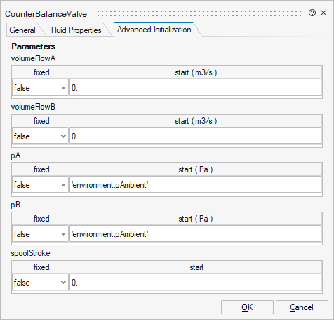

mo_enableStrokeOutput | enableStrokeOutput | Enable spool stroke output | Number | 0 |

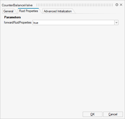

mo_forwardFluidProperties | forwardFluidProperties | Forward fluid properties between ports | Scalar | true |
mo_volumeFlowA | volumeFlowA | volumeFlowA | Structure | |
mo_volumeFlowA/fixed | fixed | Cell of scalars | true | |
mo_volumeFlowA/start | start | Cell of scalars | ||
mo_volumeFlowB | volumeFlowB | volumeFlowB | Structure | |
mo_volumeFlowB/fixed | fixed | Cell of scalars | true | |
mo_volumeFlowB/start | start | Cell of scalars | ||
mo_pA/start | start | Cell of scalars | ||
mo_pB | pB | pB | Structure | |
mo_pB/fixed | fixed | Cell of scalars | true | |
mo_pB/start | start | Cell of scalars | ||
mo_spoolStroke | spoolStroke | spoolStroke | Structure | |
mo_spoolStroke/fixed | fixed | Cell of scalars | true | |
mo_spoolStroke/start | start | Cell of scalars |
