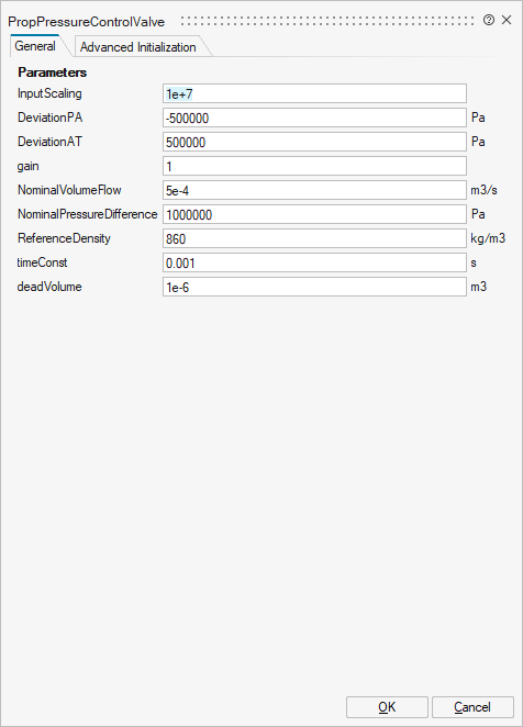

mo_InputScaling | InputScaling | Input scaling | Scalar | |
mo_DeviationPA | DeviationPA | Deviation P-A | Scalar | |
mo_DeviationAT | DeviationAT | Deviation A-T | Scalar | |
mo_gain | gain | Controller gain | Scalar | |
mo_NominalVolumeFlow | NominalVolumeFlow | Nominal volume flow | Scalar | |
mo_NominalPressureDifference | NominalPressureDifference | Nominal pressure difference | Scalar | |
mo_ReferenceDensity | ReferenceDensity | Reference density for volume flow and pressure difference | Scalar | |
mo_timeConst | timeConst | Response time of valve spool | Scalar | |

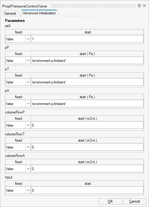

mo_relX | relX | relX | Structure | |
mo_relX/fixed | fixed | Cell of scalars | true | |
mo_relX/start | start | Cell of scalars | ||
mo_pP | pP | pP | Structure | |
mo_pP/fixed | fixed | Cell of scalars | true | |
mo_pP/start | start | Cell of scalars | ||
mo_pT | pT | pT | Structure | |
mo_pT/fixed | fixed | Cell of scalars | true | |
mo_pT/start | start | Cell of scalars | ||
mo_pA/start | start | Cell of scalars | ||
mo_volumeFlowP | volumeFlowP | volumeFlowP | Structure | |
mo_volumeFlowP/fixed | fixed | Cell of scalars | true | |
mo_volumeFlowP/start | start | Cell of scalars | ||
mo_volumeFlowT | volumeFlowT | volumeFlowT | Structure | |
mo_volumeFlowT/fixed | fixed | Cell of scalars | true | |
mo_volumeFlowT/start | start | Cell of scalars | ||
mo_volumeFlowA | volumeFlowA | volumeFlowA | Structure | |
mo_volumeFlowA/fixed | fixed | Cell of scalars | true | |
mo_volumeFlowA/start | start | Cell of scalars | ||
mo_Input | Input | Input | Structure | |
mo_Input/fixed | fixed | Cell of scalars | true | |
mo_Input/start | start | Cell of scalars |
