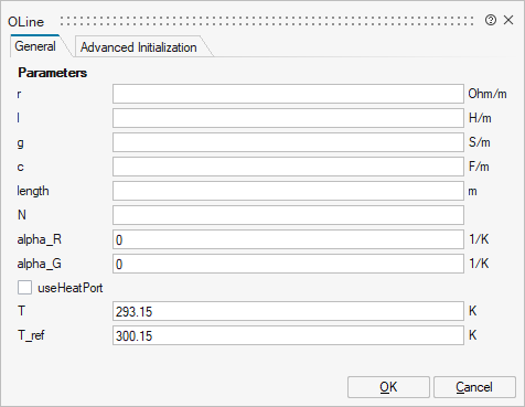

mo_r | r | Resistance per meter | Scalar | |
mo_l | l | Inductance per meter | Scalar | |
mo_g | g | Conductance per meter | Scalar | |
mo_c | c | Capacitance per meter | Scalar | |
mo_length | length | Length of line | Scalar | |
mo_N | N | Number of lumped segments | Scalar | |
mo_alpha_R | alpha_R | Temperature coefficient of resistance (R_actual = R*(1 + alpha*(T_heatPort - T_ref)) | Scalar | |
mo_alpha_G | alpha_G | Temperature coefficient of conductance (G_actual = G/(1 + alpha*(T_heatPort - T_ref)) | Scalar | |
mo_useHeatPort | useHeatPort | =true, if HeatPort is enabled | Number | 0 |
mo_T | T | Fixed device temperature if useHeatPort = false | Scalar | |
mo_T_ref | T_ref | Scalar | ||
mo_rm | rm | Vector | ||
mo_lm | lm | Vector |

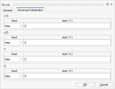

mo_v13 | v13 | v13 | Structure | |
mo_v13/fixed | fixed | Cell of scalars | true | |
mo_v13/start | start | Cell of scalars | ||
mo_v23 | v23 | v23 | Structure | |
mo_v23/fixed | fixed | Cell of scalars | true | |
mo_v23/start | start | Cell of scalars | ||
mo_i1 | i1 | i1 | Structure | |
mo_i1/fixed | fixed | Cell of scalars | true | |
mo_i1/start | start | Cell of scalars | ||
mo_i2 | i2 | i2 | Structure | |
mo_i2/fixed | fixed | Cell of scalars | true | |
mo_i2/start | start | Cell of scalars |
