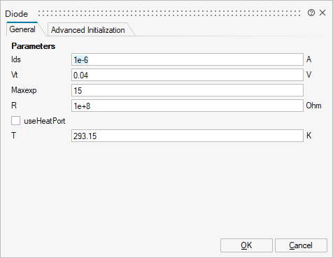

The simple diode is a one port. It consists of the diode itself and an parallel ohmic resistance R. The diode formula is:
v/vt i = ids ( e - 1).
If the exponent v/vt reaches the limit maxex, the diode characteristic is linearly continued to avoid overflow.
Please note: In case of useHeatPort=true the temperature dependence of the electrical behavior is not modelled yet. The parameters are not temperature dependent.
mo_Ids | Ids | Saturation current | Scalar | |
mo_Vt | Vt | Voltage equivalent of temperature (kT/qn) | Scalar | |
mo_Maxexp | Maxexp | Max. exponent for linear continuation | Scalar | |
mo_R | R | Parallel ohmic resistance | Scalar | |
mo_T | T | Fixed device temperature if useHeatPort = false | Scalar |

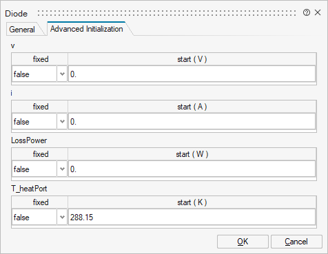

mo_v | v | v | Structure | |
mo_v/fixed | fixed | Cell of scalars | true | |
mo_v/start | start | Cell of scalars | ||
mo_i | i | i | Structure | |
mo_i/fixed | fixed | Cell of scalars | true | |
mo_i/start | start | Cell of scalars | ||
mo_LossPower | LossPower | LossPower | Structure | |
mo_LossPower/fixed | fixed | Cell of scalars | true | |
mo_LossPower/start | start | Cell of scalars | ||
mo_T_heatPort | T_heatPort | T_heatPort | Structure | |
mo_T_heatPort/fixed | fixed | Cell of scalars | true | |
mo_T_heatPort/start | start | Cell of scalars |
