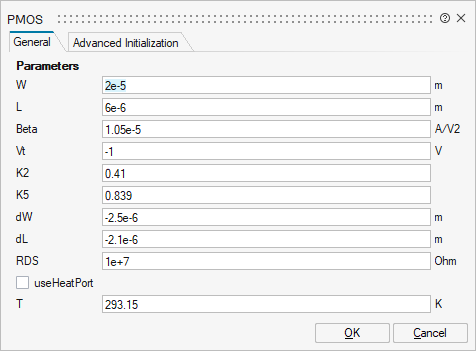

Some typical parameter sets are:
W L Beta Vt K2 K5 DW DL m m A/V^2 V - - m m 50.e-6 8.e-6 0.0085e-3 -0.15 0.41 0.839 -3.8e-6 -4.0e-6 20.e-6 6.e-6 0.0105e-3 -1.0 0.41 0.839 -2.5e-6 -2.1e-6 30.e-6 5.e-6 0.0059e-3 -0.3 0.98 1.01 0 -3.9e-6 30.e-6 5.e-6 0.0152e-3 -0.69 0.104 1.1 -0.8e-6 -0.4e-6 30.e-6 5.e-6 0.0163e-3 -0.69 0.104 1.1 -0.8e-6 -0.4e-6 30.e-6 5.e-6 0.0182e-3 -0.69 0.086 1.06 -0.1e-6 -0.6e-6 20.e-6 6.e-6 0.0074e-3 -1. 0.4 0.59 0 0
mo_W | W | Width | Scalar | |
mo_L | L | Length | Scalar | |
mo_Beta | Beta | Transconductance parameter | Scalar | |
mo_Vt | Vt | Zero bias threshold voltage | Scalar | |
mo_K2 | K2 | Bulk threshold parameter | Scalar | |
mo_K5 | K5 | Reduction of pinch-off region | Scalar | |
mo_dW | dW | Narrowing of channel | Scalar | |
mo_dL | dL | Shortening of channel | Scalar | |
mo_RDS | RDS | Drain-Source-Resistance | Scalar | |
mo_T | T | Fixed device temperature if useHeatPort = false | Scalar |

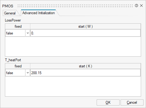

mo_LossPower | LossPower | LossPower | Structure | |
mo_LossPower/fixed | fixed | Cell of scalars | true | |
mo_LossPower/start | start | Cell of scalars | ||
mo_T_heatPort | T_heatPort | T_heatPort | Structure | |
mo_T_heatPort/fixed | fixed | Cell of scalars | true | |
mo_T_heatPort/start | start | Cell of scalars |
