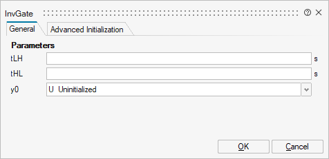

The InvGate model has a single valued input, and a single valued output. It is composed by a Basic Not and an InertialDelaySensitive. Its parameters are the delay parameters (rise and fall inertial delay time, and initial value).
mo_tLH | tLH | Rise inertial delay | Scalar | |
mo_tHL | tHL | Fall inertial delay | Scalar | |
mo_y0 | y0 | Initial value of output | Structure | |
mo_y0/choice1 | U Uninitialized | Number | 0 | |
mo_y0/choice2 | X Forcing Unknown | Number | 0 | |
mo_y0/choice3 | 0 Forcing 0 | Number | 0 | |
mo_y0/choice4 | 1 Forcing 1 | Number | 0 | |
mo_y0/choice5 | Z High Impedance | Number | 0 | |
mo_y0/choice6 | W Weak Unknown | Number | 0 | |
mo_y0/choice7 | L Weak 0 | Number | 0 | |
mo_y0/choice8 | H Weak 1 | Number | 0 | |
mo_y0/choice9 | - Do not care | Number | 0 |

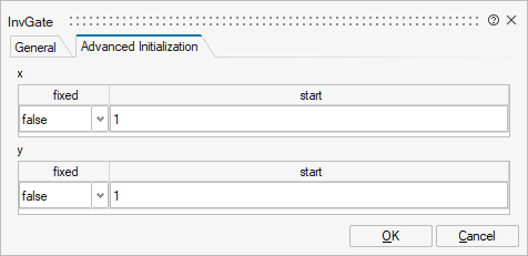

mo_x | x | x | Structure | |
mo_x/fixed | fixed | Cell of scalars | true | |
mo_x/start | start | Cell of scalars | ||
mo_y | y | y | Structure | |
mo_y/fixed | fixed | Cell of scalars | true | |
mo_y/start | start | Cell of scalars |
