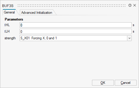

mo_tHL | tHL | High->Low delay | Scalar | |
mo_tLH | tLH | Low->High delay | Scalar | |
mo_strength | strength | output strength | Structure | |
mo_strength/choice1 | S_X01 Forcing X, 0 and 1 | Number | 0 | |
mo_strength/choice2 | S_X0H Forcing X, 0 and Weak 1 | Number | 0 | |
mo_strength/choice3 | S_XL1 Forcing X, 1 and Weak 0 | Number | 0 | |
mo_strength/choice4 | S_X0Z Forcing X, 0 and High Impedance | Number | 0 | |
mo_strength/choice5 | S_XZ1 Forcing X, 1 and High Impedance | Number | 0 | |
mo_strength/choice6 | S_WLH Weak X, 0 and 1 | Number | 0 | |
mo_strength/choice7 | S_WLZ Weak X, 0 and High Impedance | Number | 0 | |
mo_strength/choice8 | S_WZH Weak X, 1 and High Impedance | Number | 0 | |
mo_strength/choice9 | S_W0H Weak X, 1 and Forcing 0 | Number | 0 | |
mo_strength/choice10 | S_WL1 Weak X, 0 and Forcing 1 | Number | 0 |

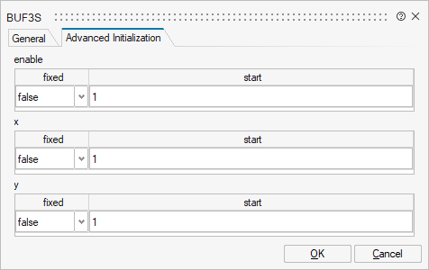

mo_enable | enable | enable | Structure | |
mo_enable/fixed | fixed | Cell of scalars | true | |
mo_enable/start | start | Cell of scalars | ||
mo_x | x | x | Structure | |
mo_x/fixed | fixed | Cell of scalars | true | |
mo_x/start | start | Cell of scalars | ||
mo_y | y | y | Structure | |
mo_y/fixed | fixed | Cell of scalars | true | |
mo_y/start | start | Cell of scalars |
