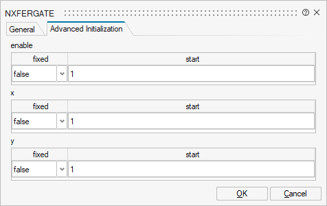

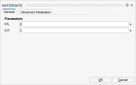

mo_tHL | tHL | High->Low delay | Scalar | |
mo_tLH | tLH | Low->High delay | Scalar |
mo_enable | enable | enable | Structure | |
mo_enable/fixed | fixed | Cell of scalars | true | |
mo_enable/start | start | Cell of scalars | ||
mo_x | x | x | Structure | |
mo_x/fixed | fixed | Cell of scalars | true | |
mo_x/start | start | Cell of scalars | ||
mo_y | y | y | Structure | |
mo_y/fixed | fixed | Cell of scalars | true | |
mo_y/start | start | Cell of scalars |
enable | implicit | input | 1 | |
x | implicit | input | 2 | |
y | implicit | output | 1 |
