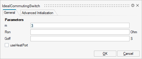

Contains m ideal commuting switches (Modelica.Electrical.Analog.Ideal.IdealCommutingSwitch).
mo_Ron | Ron | Closed switch resistance | Vector | |
mo_Goff | Goff | Opened switch conductance | Vector | |
mo_mh | mh | Number of heatPorts=number of phases | Scalar | |
mo_useHeatPort | useHeatPort | =true, if all heat ports are enabled | Number | 0 |
mo_T | T | Fixed device temperatures if useHeatPort = false | Vector |

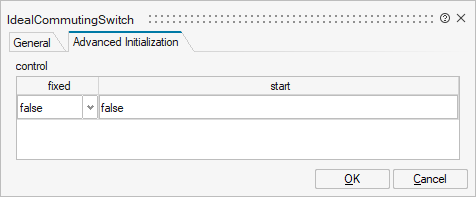

mo_control | control | control | Structure | |
mo_control/fixed | fixed | Cell of vectors | true | |
mo_control/start | start | Cell of vectors |
control | implicit | true => p--n2 connected, false => p--n1 connected | input | 1 |
