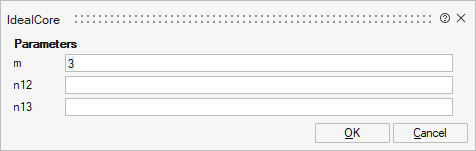

Ideal transformer with 3 windings: no magnetizing current.Parameters
mo_n12 | n12 | Turns ratio 1:2 | Scalar | |
mo_n13 | n13 | Turns ratio 1:3 | Scalar |
