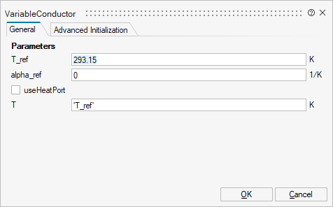

mo_T_ref | T_ref | Reference temperature | Scalar | |
mo_alpha_ref | alpha_ref | Temperature coefficient of conductance (G_actual = G_ref/(1 + alpha_ref*(heatPort.T - T_ref)) | Scalar | |
mo_useHeatPort | useHeatPort | =true, if heatPort is enabled | Number | 0 |
mo_T | T | Fixed device temperature if useHeatPort = false | Scalar |

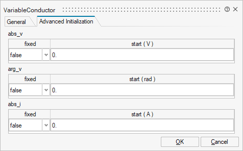

mo_abs_v | abs_v | abs_v | Structure | |
mo_abs_v/fixed | fixed | Cell of scalars | true | |
mo_abs_v/start | start | Cell of scalars | ||
mo_arg_v | arg_v | arg_v | Structure | |
mo_arg_v/fixed | fixed | Cell of scalars | true | |
mo_arg_v/start | start | Cell of scalars | ||
mo_abs_i | abs_i | abs_i | Structure | |
mo_abs_i/fixed | fixed | Cell of scalars | true | |
mo_abs_i/start | start | Cell of scalars | ||
mo_arg_i | arg_i | arg_i | Structure | |
mo_arg_i/fixed | fixed | Cell of scalars | true | |
mo_arg_i/start | start | Cell of scalars | ||
