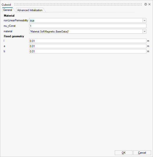

mo_nonLinearPermeability | nonLinearPermeability | = true, if non-linear rel. permeability is used, otherwise constant rel. permeability | Scalar | true |
mo_mu_rConst | mu_rConst | Constant relative permeability; used if nonLinearPermeability = false | Scalar | |
mo_material | material | Ferromagnetic material characteristics; used if nonLinearPermeability = true | FromModelica('Modelica.Magnetic.FluxTubes.Material.SoftMagnetic.BaseData') | |
mo_l | l | Length in direction of flux | Scalar | |
mo_a | a | Width of rectangular cross-section | Scalar | |
mo_b | b | Height of rectangular cross-section | Scalar |

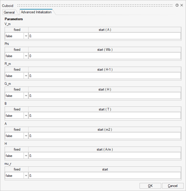

mo_V_m | V_m | V_m | Structure | |
mo_V_m/fixed | fixed | Cell of scalars | true | |
mo_V_m/start | start | Cell of scalars | ||
mo_Phi | Phi | Phi | Structure | |
mo_Phi/fixed | fixed | Cell of scalars | true | |
mo_Phi/start | start | Cell of scalars | ||
mo_R_m | R_m | R_m | Structure | |
mo_R_m/fixed | fixed | Cell of scalars | true | |
mo_R_m/start | start | Cell of scalars | ||
mo_G_m | G_m | G_m | Structure | |
mo_G_m/fixed | fixed | Cell of scalars | true | |
mo_G_m/start | start | Cell of scalars | ||
mo_B | B | B | Structure | |
mo_B/fixed | fixed | Cell of scalars | true | |
mo_B/start | start | Cell of scalars | ||
mo_A | A | A | Structure | |
mo_A/fixed | fixed | Cell of scalars | true | |
mo_A/start | start | Cell of scalars | ||
mo_H | H | H | Structure | |
mo_H/fixed | fixed | Cell of scalars | true | |
mo_H/start | start | Cell of scalars | ||
mo_mu_r | mu_r | mu_r | Structure | |
mo_mu_r/fixed | fixed | Cell of scalars | true | |
mo_mu_r/start | start | Cell of scalars |
