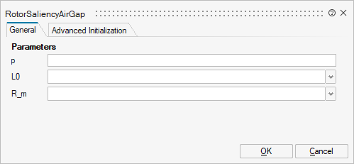

mo_p | p | Number of pole pairs | Scalar | |
mo_L0 | L0 | Salient inductance of a single unchorded coil w.r.t. the fundamental wave | FromModelica('Modelica.Magnetic.FundamentalWave.Types.SalientInductance') | |
mo_R_m | R_m | Reluctance of the air gap model | FromModelica('Modelica.Magnetic.FundamentalWave.Types.SalientReluctance') |

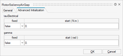

mo_tauElectrical | tauElectrical | tauElectrical | Structure | |
mo_tauElectrical/fixed | fixed | Cell of scalars | true | |
mo_tauElectrical/start | start | Cell of scalars | ||
mo_gamma | gamma | gamma | Structure | |
mo_gamma/fixed | fixed | Cell of scalars | true | |
mo_gamma/start | start | Cell of scalars |
