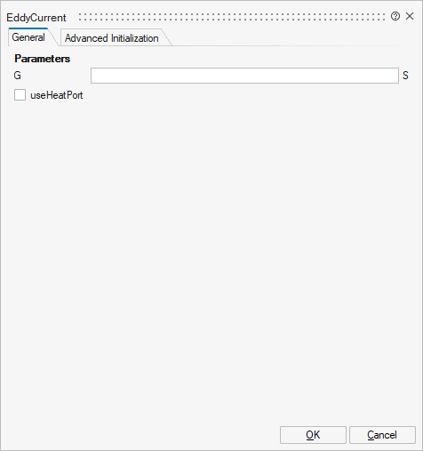

mo_G | G | Equivalent symmetric loss conductance | Scalar | |
mo_T | T | Fixed device temperature if useHeatPort = false | Scalar |

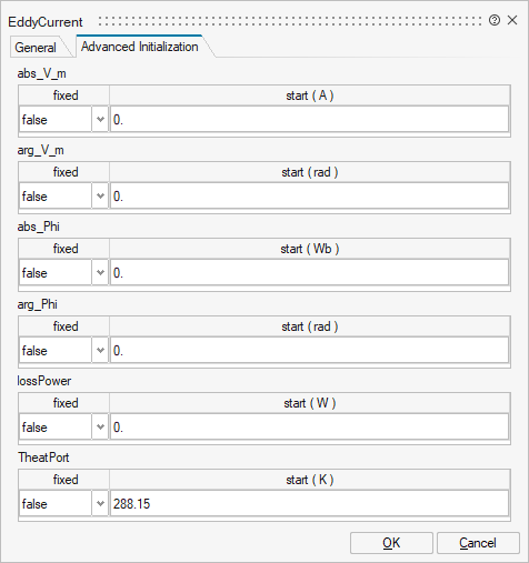

mo_abs_V_m | abs_V_m | abs_V_m | Structure | |
mo_abs_V_m/fixed | fixed | Cell of scalars | true | |
mo_abs_V_m/start | start | Cell of scalars | ||
mo_arg_V_m | arg_V_m | arg_V_m | Structure | |
mo_arg_V_m/fixed | fixed | Cell of scalars | true | |
mo_arg_V_m/start | start | Cell of scalars | ||
mo_abs_Phi | abs_Phi | abs_Phi | Structure | |
mo_abs_Phi/fixed | fixed | Cell of scalars | true | |
mo_abs_Phi/start | start | Cell of scalars | ||
mo_arg_Phi | arg_Phi | arg_Phi | Structure | |
mo_arg_Phi/fixed | fixed | Cell of scalars | true | |
mo_arg_Phi/start | start | Cell of scalars | ||
mo_lossPower | lossPower | lossPower | Structure | |
mo_lossPower/fixed | fixed | Cell of scalars | true | |
mo_lossPower/start | start | Cell of scalars | ||
mo_TheatPort | TheatPort | TheatPort | Structure | |
mo_TheatPort/fixed | fixed | Cell of scalars | true | |
mo_TheatPort/start | start | Cell of scalars |
