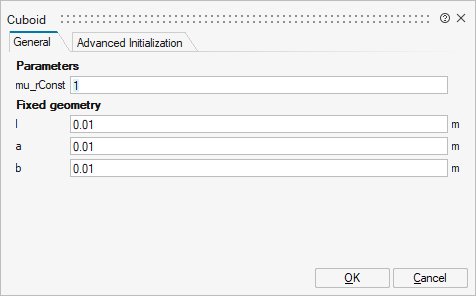

The cuboid models the reluctance with rectangular dimensions a and b, and length, l
the magnetic reluctance by:
The area of cross section is determined by:
mo_mu_rConst | mu_rConst | Constant relative permeability | Scalar | |
mo_l | l | Length in direction of flux | Scalar | |
mo_a | a | Width of rectangular cross-section | Scalar | |
mo_b | b | Height of rectangular cross-section | Scalar |

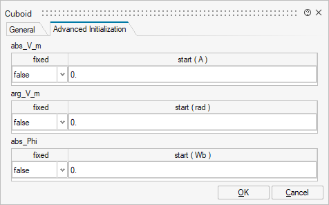

mo_abs_V_m | abs_V_m | abs_V_m | Structure | |
mo_abs_V_m/fixed | fixed | Cell of scalars | true | |
mo_abs_V_m/start | start | Cell of scalars | ||
mo_arg_V_m | arg_V_m | arg_V_m | Structure | |
mo_arg_V_m/fixed | fixed | Cell of scalars | true | |
mo_arg_V_m/start | start | Cell of scalars | ||
mo_abs_Phi | abs_Phi | abs_Phi | Structure | |
mo_abs_Phi/fixed | fixed | Cell of scalars | true | |
mo_abs_Phi/start | start | Cell of scalars | ||
mo_arg_Phi | arg_Phi | arg_Phi | Structure | |
mo_arg_Phi/fixed | fixed | Cell of scalars | true | |
mo_arg_Phi/start | start | Cell of scalars | ||
mo_omega | omega | omega | Structure | |
mo_omega/fixed | fixed | Cell of scalars | true | |
mo_omega/start | start | Cell of scalars | ||
mo_R_m | R_m | R_m | Structure | |
mo_R_m/fixed | fixed | Cell of scalars | true | |
mo_R_m/start | start | Cell of scalars | ||
mo_G_m | G_m | G_m | Structure | |
mo_G_m/fixed | fixed | Cell of scalars | true | |
mo_G_m/start | start | Cell of scalars | ||
mo_abs_B | abs_B | abs_B | Structure | |
mo_abs_B/fixed | fixed | Cell of scalars | true | |
mo_abs_B/start | start | Cell of scalars | ||
mo_arg_B | arg_B | arg_B | Structure | |
mo_arg_B/fixed | fixed | Cell of scalars | true | |
mo_arg_B/start | start | Cell of scalars | ||
mo_A | A | A | Structure | |
mo_A/fixed | fixed | Cell of scalars | true | |
mo_A/start | start | Cell of scalars | ||
mo_abs_H | abs_H | abs_H | Structure | |
mo_abs_H/fixed | fixed | Cell of scalars | true | |
mo_abs_H/start | start | Cell of scalars | ||
mo_arg_H | arg_H | arg_H | Structure | |
mo_arg_H/fixed | fixed | Cell of scalars | true | |
mo_arg_H/start | start | Cell of scalars | ||
mo_mu_r | mu_r | mu_r | Structure | |
mo_mu_r/fixed | fixed | Cell of scalars | true | |
mo_mu_r/start | start | Cell of scalars |
